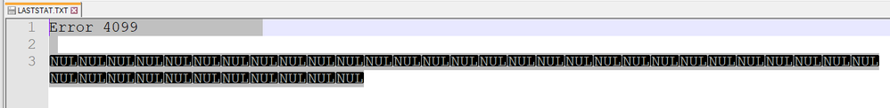

It mounts as E: drive as SKB_S32K144 and laststack.txt reads:
Ready.

I've attempted to flash the .elf file directly using S32 Design Studio but got an error saying:
Error while launching command: --version
11,373 Views
sparkee
Contributor V
The error goes away when I uncheck the Generate Makefile box but it's not programming my device or doing a fraction of the building it was doing when making.
