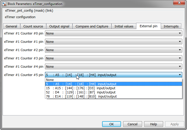

I think I found another thing:
The eTimer Mux table is probably also not completely right. Module 0 seems to have the right values, but module 1 and 2 are probably wrong, since the IMCR values are all "-1". Please look at the corresponding .png file.

In respect with the second item, those structures implement the Table 4-7 Pin Muxing and Table 4-9 Peripheral Muxing from MPC5744P Reference Manual. The -1 is usually used for reserved/not implemented functionalities. I do not the reason behind this implementation but i will try to find out (at this point i guess is hw specific) .

Also I edited the pin muxing table and now everything I tested so far works. I'm pretty sure that it should not be a hardware limitation since you are actually specifying the IO pins in the quick start guide of the DEVKIT.
Also in Simulink you can choose the pins, but they do not get muxed obviously.
