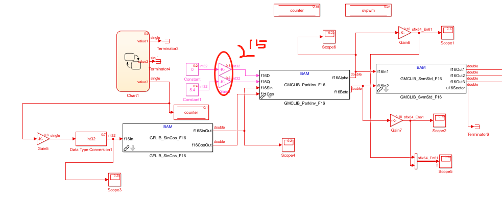

Hi Daniel,
I meet some problems,please help me.
I want to when I use the 'Automotive Math and Motor Control Library' module,I use 'GMCLIB_ParkInv_F16' module,I found that when I Input(Ud or Uq) the value that larger than 5.4*2^15,the output(Uα or Uβ) was zero,I don't kown why.And I want to change this module's code,but I could not find the place to change.Please help me!!!
Thank you.
Yuyuan Wang.
1,473 Views
Daniel_Popa
I've just move this question as a new thread since it was added to a different topic and discovered accidentally. Is this this an issue for you? Have you fix it?
If not, please be aware that the GMCLIB_ParkInv_F16 accept only values between -32768 : 32767. Any other values might produce wrong results.
