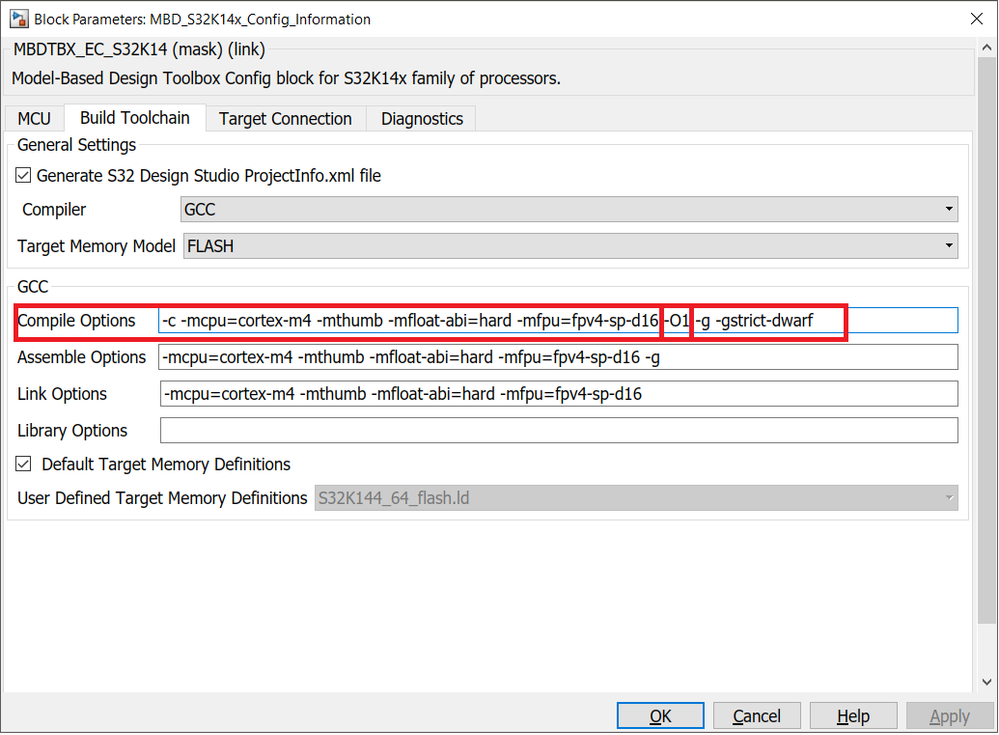

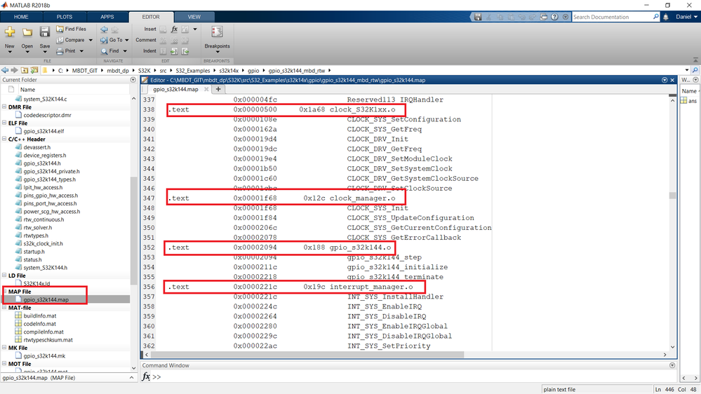

All the code that is generated is based on the NXP S32K SDK drivers - hence the need for additional program space. You can easily see which drivers are used and how much program/data memory space it takes by checking the map file generated for each model.
Even for a simple Simulink model you have pointed out, there are a lot of initializations that happen under the hood in order to startup the MCU.

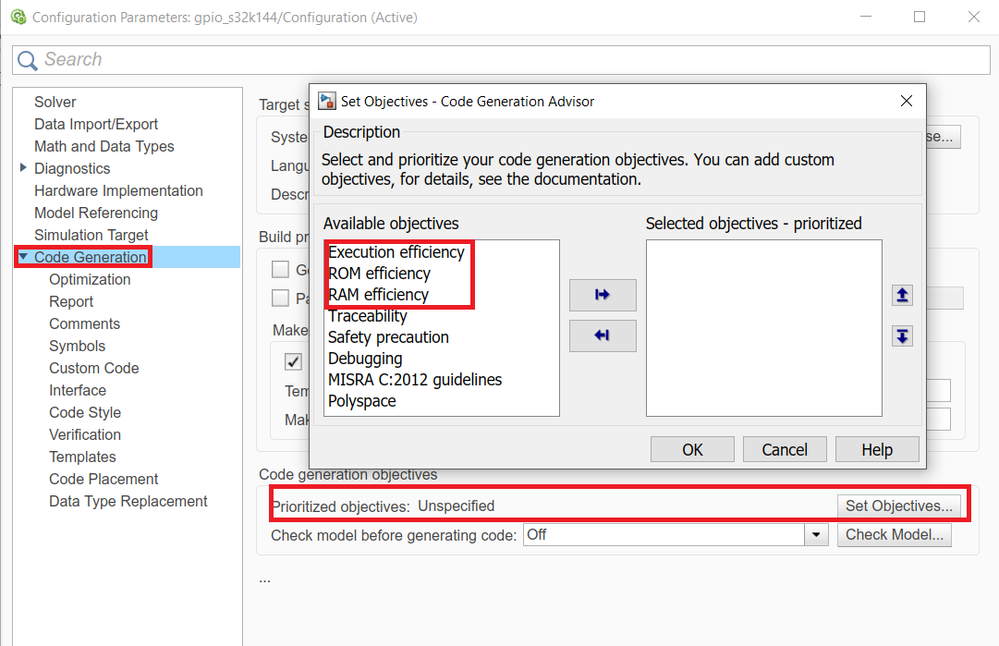

Fortunately, Simulink comes with a set of optimization features that may help you to reduce the code size or improve the execution speed of the program.
The ugly truth is that those optimization works for the Simulink model part (user application) and not the "mcu startup code" which is injected by the NXP toolbox in order to bring the MCU up to life.
To reduce the code size even further, you may use the cross-compiler optimization flags. In case of GCC you can enable the -Os flag instead of -O1 (GCC flags are described here)
Anyhow,  keep in mind that there is a minimum size that is required for SDK driver initialization that can't be reduced further since it is absolutely necessary for the MCU startup.

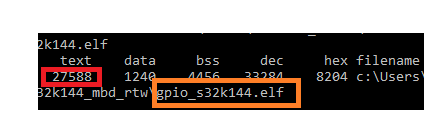

Thank you very match for your support, i succeeded to identify the code size (refer to the following):

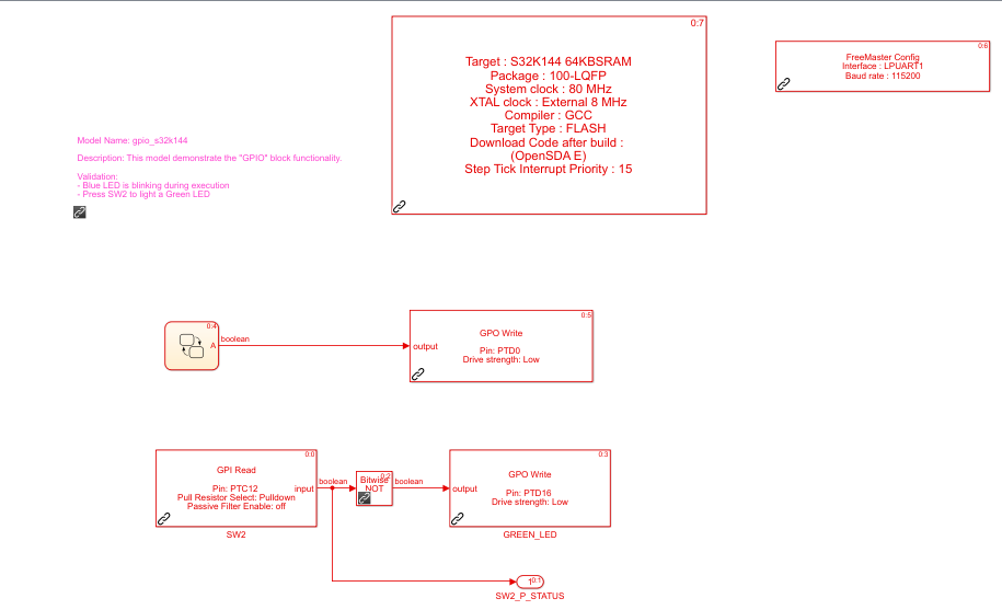

However, i'm a little bit surprised to see that a simple application like LED toggling (gpio_s32k144 exemple below) costs almost 27 kByte. Is there any explanation ? is there a way to reduce the size ? thanks in advance

Yes, it is possible by analyzing the .map file. But it easier to use the arm-none-eabi-size tool. Please check the link [1] to see how to use it and to understand the values please read [2]. Also the same question has been discussed on [3].
