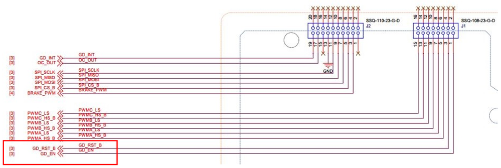

  • On MotorGD DevKit the J1_1 and J1_3 pins are assigned to Enable and Reset functionalities for onboard MC34GD3000 integrated circuit pre-driver (see Fig. 1),
Fig.1  MotorGD DevKit pin-header

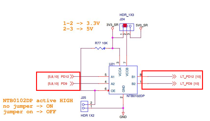

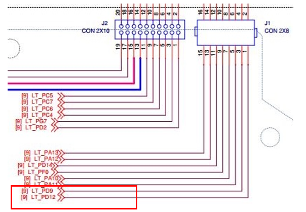

  • On MPC5744P DevKit (see Fig. 2) J1_1(LT_PD12) and J1_3(LT_PD9) pins are connected to MPC5744P microcontroller PD12 and PD9 pins, thru an integrated circuit (see Fig. 3) U21 NTB0102DP (dual supply translating receiver),
Fig. 2 MPC5744P DevKit pin-headerFig. 3 Level translator schematic

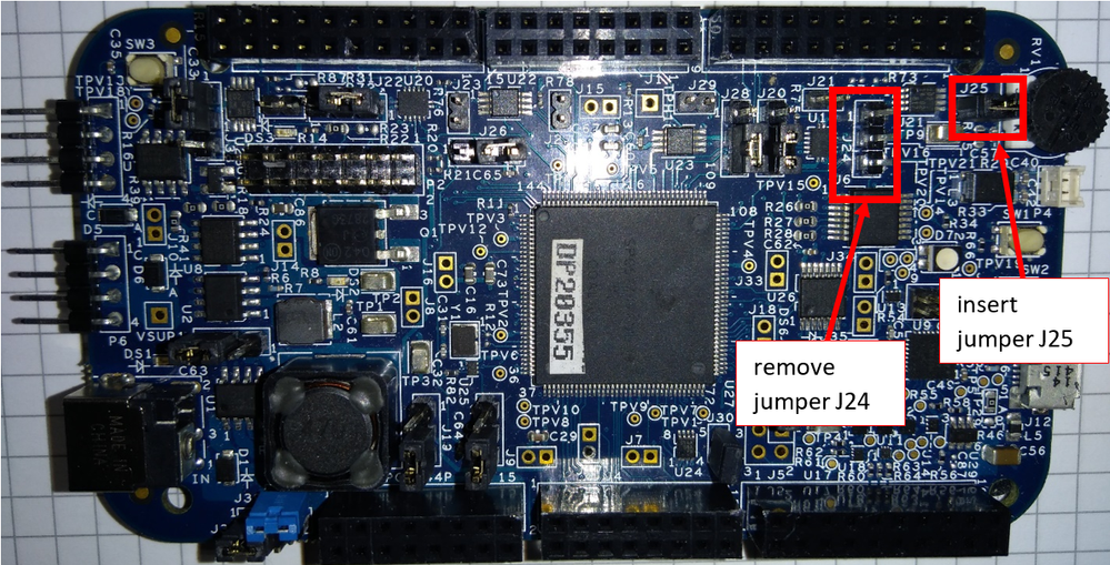

First thing that should be made, is to disable the outputs of U21 NTB0102DP. To do that, jumper J25 (see Fig. 5) it has to be ON (closed) and optional jumper J24 can be disconnected completely (that will turn off B side of translating receiver integrated circuit).
Fig. 5 Jumper settings on MPC5744P DevKit board

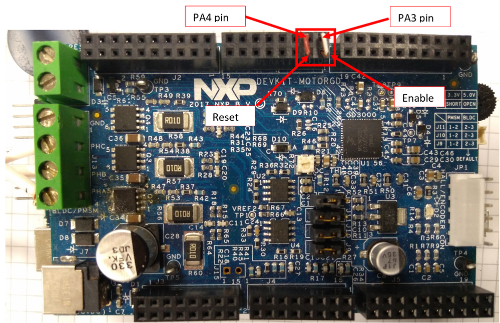

Second step is to assign reset and enable functionalities to other pins (e.g. for enable use PA3 pin and for reset use PA4 pin).
Third step is to route (Fig. 6) the chosen pins (PA3 and PA4) to the default pins (J1_1 and J1_3 pins) and since MPotorGD DevKit is placed over MPC5744P DevKit, routing those pins can be made with wire jumpers directly on MotorGD DevKit pin-header J1.
Fig. 6 Routing reset an enable pin functionalities
