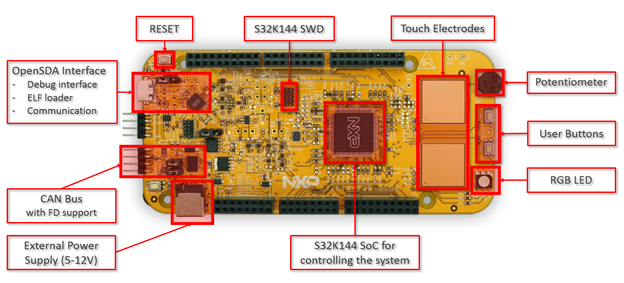

NXP’s S32K144EVB Development Kit is one of the choices that puts in your hands a small form factor, low cost (US$49) and feature-rich platform which can prove to be a perfect development system for quick application prototyping and demonstration.
Fig. 1: S32K144EVB's main features
The main component of this development platform is the S32K144 MCU that integrates in a single SoC a 32bit Cortex M4F core capable of running at 112MHz with 512KB of Flash memory and 54KB of RAM. Dedicated hardware peripherals and a large collection of IP communication blocks makes this MCU a suitable candidate for various industrial and automotive applications.

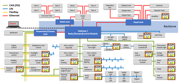

In today’s fast growing complex than ever automotive market these is a lot of interest in various modules capable to control and coordinate multiple functionalities. Such microprocessors need to be flawlessly integrated within the cars various computing domains and must be ultra-reliable when operating in a such harsh environment.
Fig. 2: A typical vehicle distributed control architecture and places where S32K is a perfect match
NXP’s S32K product families are specifically designed to address all these aspects, and to demonstrate how easy it is to build complex applications let us consider a typical use case that maps over a distributed automotive Body Control Module domain as the one shown in Fig. 2.

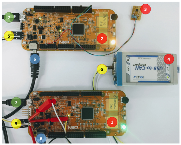

We can easily prototype such scenario in a couple of minutes with NXP’s S32K development boards and NXP’s Model-Based Design MATLAB toolboxes.
For the hardware setup, two S32K144EVB development boards are used. These are connected through CAN bus (both on CAN0 instance available directly on the board via J13 connector) and supplied with a 12 volts external power supply due to the CAN transceivers power requirements. The one which acts as CAN node-SLAVE has an Si7021 temperature sensor, connected on FlexIO I2C protocol using PTD0 GPIO as I2C SDA and PTD1 GPIOI as I2C SCL communication lines.  A CAN sniffer was also added to catch some packets over the network.
The real hardware setup with the main components and layout is shown in Fig. 3.
Fig. 3: CAN-bus network used to emulate a car body control module
The main components of the setup are:
  • Two S32K144EVB development kits which are configured to act as MASTER (1) and SLAVE (2). The boards are supply with 12V (6) and connected via a PC via microUSB (7) for program loading and debugging during development phase;
  • One Si7021 temperature sensor that support I2C communication protocol is connected with the SLAVE (2) via FlexIO I2C peripheral;
  • CAN (5) network that interconnects the two boards, allowing to pass control and data messages;
  • CAN sniffer (4) that acts like a diagnostic tool;

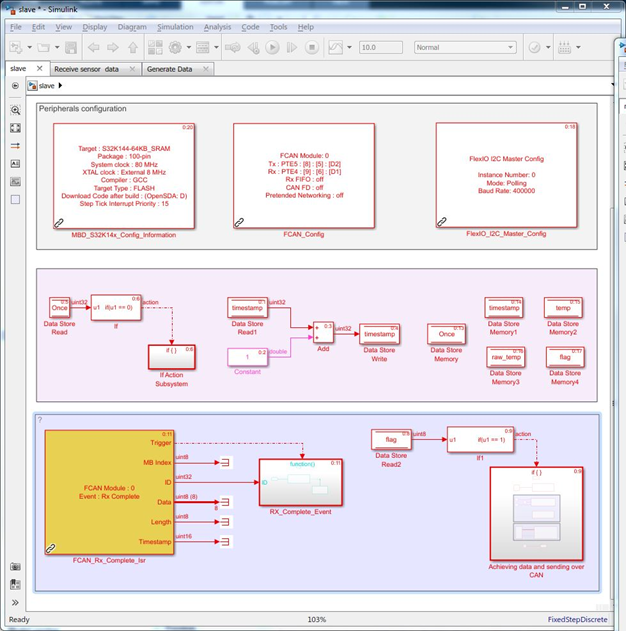

Part A: CAN node-SLAVE Programming
The job of the SLAVE board is to measure the temperature from the sensor and to send the values via CAN bus to the MASTER board that acts like a gateway. The Simulink model used to receive/transmit CAN messages and data exchange with the sensor via the I2C protocol over FlexIO is shown below.
Fig. 4: Simulink model for the application running on the SLAVE board: It implements 2 communication protocols: CAN and I2C
This model implements three basic functionalities:
  1. Reading data from sensor
  2. Handle the CAN receive messages
  3. Handle the CAN transmit messages

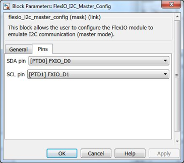

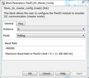

A.1. Reading Data From Sensor

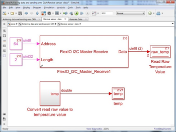

The temperature sensor uses I2C protocol for exchanging the temperature values. To achieve that, the FlexIO peripheral must be configured by adding a FlexIO_I2C_Master_Config block.
A standard I2C peripheral can be used to implement the communication with the sensor. To demonstrate the capabilities of the S32K144 we choose to use the FlexIO peripheral since it can be configured in multiple way to extend the functionalities of standard communication ports.
The instance 0 of FlexIO peripheral is configured to run in the polling mode with a communication baud rate of 400 kHz and as dedicated communication lines: PTD0/PTD1 general purpose input/outputs pins selected to implement SDA and SCL I2C functionalities.
Fig. 5: FlexIO peripheral configuration
When the temperature acquisition is needed, the S32K144 acts as an I2C master and sends a packet consisting of command “227” (0xE3) to the device with the address  “64” (0x40)  and “Stop bit” by using
FlexIO_I2C_Master_Transmit block.  The temperature sensor responds on I2C bus with two bytes of “raw” temperature, therefore a FlexIO_I2C_Master_Receive block need to be configured to wait two bytes from the address “64” (0x40) like in Fig 6. Also, a block that converts the data from “raw’ temperature in Celsius degrees is added.
Fig. 6: FlexIO I2C communication between S32K144 and Si7021 temperature sensor

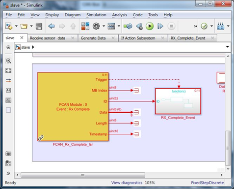

A.2. Handle the CAN receive messages

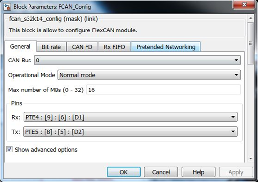

To receive and transmit data over the CAN bus, a FCAN_Config block must be added in the model. The settings are very generous because it offers to user the possibility of using in addition of standard settings some advanced options like enabling CAN FD, RX FIFO (the board can filter which messages to receive) and also Pretended Networking (some messages can also wake up the processor from sleep state).
For this example we are going to use the CAN0 instance in normal mode with a maximum of 16 message buffers as in Fig. 7.
Fig. 7: CAN peripheral configuration

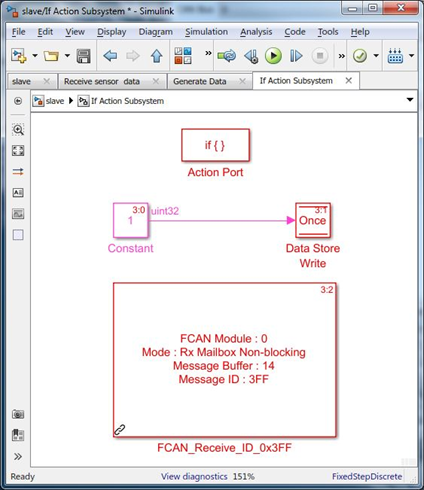

To receive a CAN message, the CAN receive interrupt must be armed using the FCAN_Receive block like in the Fig. 8. The “Once” flag variable was used because the next interrupt will be armed inside the sub-system called by the Rx complete interrupt trigger.
Fig. 8: CAN receive message handling
When a message is received, it triggers the RX_Complete_Event. The only point of interest is the message ID because a message from the 0x3FF (node-MASTER) means a starting conversion. If the address is 0x3FF the Red LED is toggled, the RX ISR is rearmed and “flag” variable is set, for later start measuring the temperature and send the value over CAN bus.
Fig. 9: Get CAN message on an interrupt

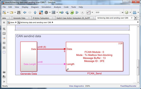

A.3. Handle the CAN transmit messages
Once the “flag” variable has been set in the RX_Complete_Event, the temperature information received from the I2C sensors is saved in the “temperature” variable so it is ready to be sent to the master node (0x3FE).
For that a FCAN_Send block is configured like in the Fig. 10. The block requires an 8 byte pack of data (“timestamp”  and “temperature”) and a data length which is a Constant of value “8”.
Fig. 10: CAN transmit message

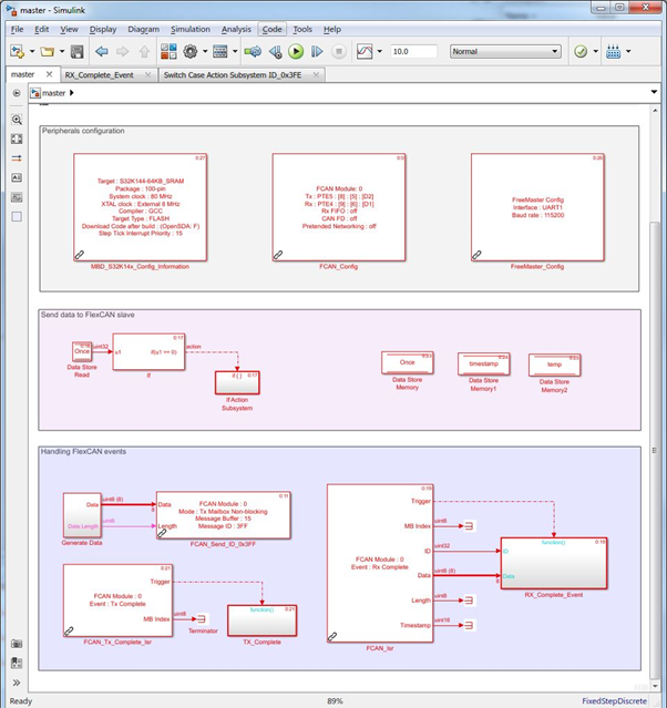

Part B: CAN node-MASTER Programming
The job of the MASTER board, is to send periodically (every half second) a message to the slave and to handle receive back of the temperature over CAN bus. Also, the CAN node-MASTER can responds to a FreeMASTER queries. The node-MASTER Simulink model that implements these functionalities is shown in Fig. 11.
Fig. 11: Simulink model for the application running on the MASTER board: It implements 2 communication protocols: CAN and UART
The CAN on the board that acts like node-MASTER needs to be configured with the same bus settings as the slave board. Sending data is done in the exactly same way as for slave. The only difference here, is that a TX_Complet_ISR block was added for calling an sub-system when the packet has been sent. This allows us to toggle the blue LED as an additional indication for message transmit.
Fig. 12: CAN transmit message to trigger temperature acquisition on node-slave
The MASTER and SLAVE are receiving CAN bus messages in a similar way using same type of Simulink blocks - arming once the trigger and then calling a sub-system from the FCAN_ISR block. The only difference on the node-MASTER side is that this time we really want to process those 8 bytes received as message payload, therefore we need to call the RX_Complete_Event sub-system using the ID and Data received as arguments.  The ID is checked and the Data is unpacked in the time-stamp and temperature variables.
Fig. 13: Handling the incoming CAN messages on node-MASTER

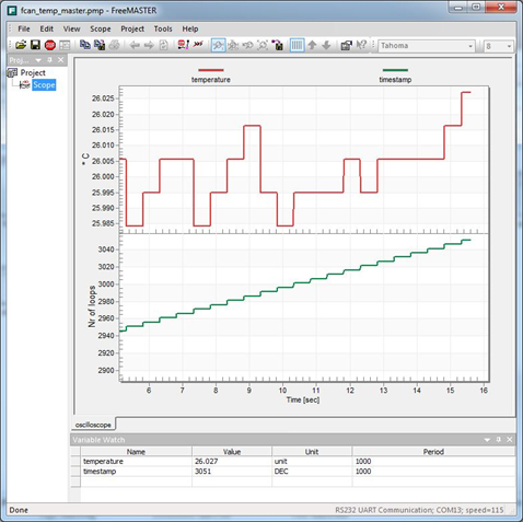

Once the models are completed and the generated code is downloaded on each the devices there are at least 2 simple ways to check the correct functionality of the master-slave CAN application on S32K144.
The first method is based on FreeMASTER tool that can be configured to read the data out of the node-MASTER via the UART interface. As it can be seen from Fig. 14, the measured temperature is about 26 degrees Celsius and the time-stamp is continuously increasing.
Fig. 14: Checking the application with FreeMASTER over the UART interface.

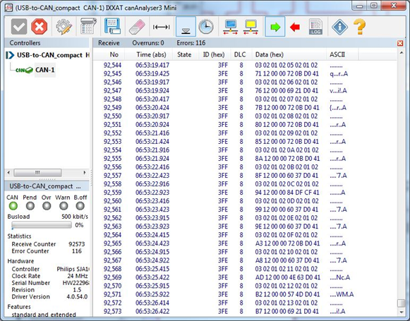

The second method that might be more expensive is based on the existence of a CAN-Sniffer. In our case we used an IXXAT can to usb converter to check the messaged on the CAN bus. This device is mainly used for debugging the CAN bus by sniffing the exchanged messages on the bus. In the Fig. 15, it can be seen “ping-pong” of messages between master (x3FF) and slave (3FE) at specific time intervals.
Fig. 15: Checking CAN messages with dedicated hardware sniffer
