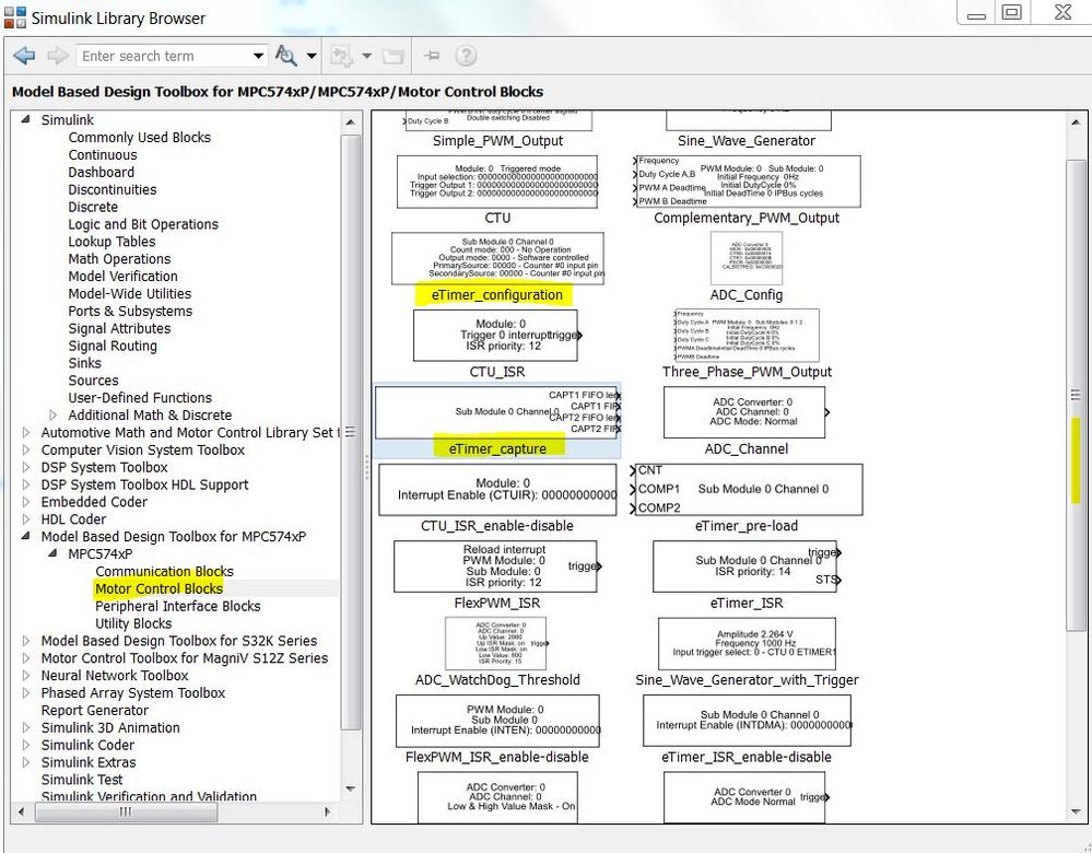

Hello Sir:
I find MBD_toolbox not having the bolck as follows:
When I use encoder to get position signal, how do I do in MBD_toolbox?
Thanks a lot.
Roger.

Hi Roger,
You can now use the eTimer_configuration and eTimer_capture blocks that offers you a high degree of flexibility in choosing what to do.
Hope this helps!

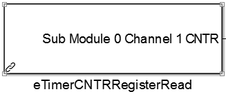

rogerdai
Hi Daniel:
I found that the capture block is not the function I want.
Will there  upgrade MBD_toolbox version to add CNTR block in the future?
Beacause the encoder IC sends out absolute position's pulses to MCU when encoder IC is reset, but the capture can't catch the pulses.
The attachment is my Model.
Roger
