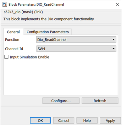

MBDT for S32K3 works in a different way than the MBDT for S32K1 works. The MBDT for S32K3 is based on the Real-Time Drivers and generates the configuration codes for the MCU using external configuration tools and not using the configuration blocks as the S32K1. This is why, on each of the MBDT blocks for the K3, you will find the Configure and the Refresh Button. Pressing the Configure button, opens the external configuration tools, like the EBTresos or S32 Configuration tools, allowing to assign pins and configure peripherals while pressing the Refresh button reads the settings from the configuration tools and updates the options inside dropdowns of the blocks.
