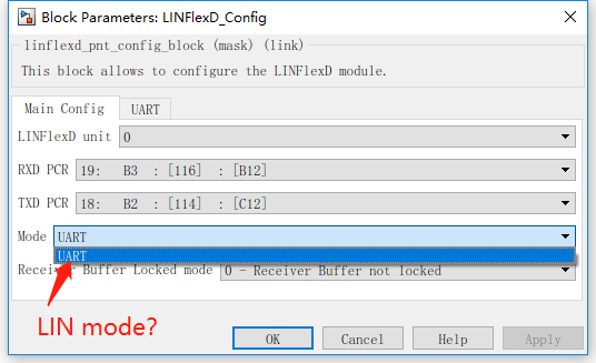

How do I configure LINFlexD_Config to be LIN mode?

Hello [email protected]‌,
Unfortunately this toolbox only supports LINFlexD in UART mode. For communication purposes this toolbox offers support for CAN, SPI and UART.
Hope this helps,
