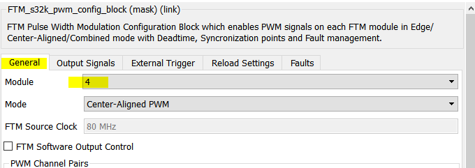

I could run up this example and has no problem, thank you both constantinrazvan.chivu and mariuslucianandrei. But I have one more issue. I want to control LED with potentiometer. I'm using S32k148 development kit and as I read from datasheet, PTE21-22-23 are the LED pins. I modelled a design as below, I chose pot pin(PTC28) for ADC input but I can't choose LED pins for FTM_PWM_Config output pin. Dropdown items are PTB14,PTC2 and PTD0, include none of LED pins. Can you also help me for this?Ftm_Pwm_Config.PNG

On the S32K148 there are 8 modules of FTM and output pins differs for each instance. So, if you need to choose the PE21,PE22 and PE23, you have to change the PWM module from module 0 to module 4.
Now, if you enable the first two pairs, (0-1) and (2-3) You will be able to directly select the required pins.
Hope this helps,
Marius

utkuckmgl
Hello mariuslucianandrei‌,
Thank you for this information, it's very clear, I'm appreciated.
