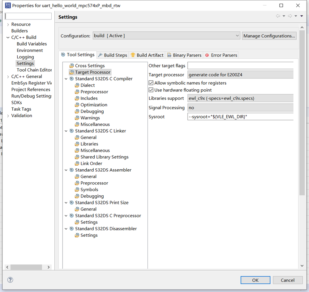

I can build my Simulink model and generate code successfully, also I can generate the .elf file and flash it to my MPC5744P. It works well. But today I want to modify the generated code and found that I just cannot build the generated code by importing projectinfo.xml, the build hammer is gray.
And I have checked the properties of the project and found that the builders are missed. Could you please offer any suggestions? Thank you very much!

And my configuration fo properties:
Could you give me some help please

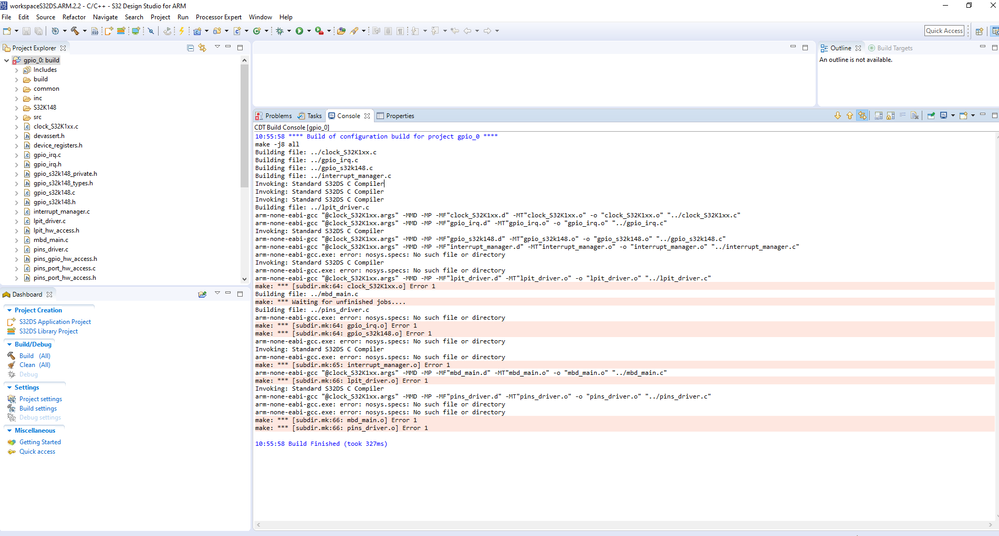

10:55:58 **** Build of configuration build for project gpio_0 ****
make -j8 all
Building file: ../clock_S32K1xx.c
Building file: ../gpio_irq.c
Building file: ../gpio_s32k148.c
Building file: ../interrupt_manager.c
Invoking: Standard S32DS C Compiler
Building file: ../lpit_driver.c
arm-none-eabi-gcc "@clock_S32K1xx.args" -MMD -MP -MF"clock_S32K1xx.d" -MT"clock_S32K1xx.o" -o "clock_S32K1xx.o" "../clock_S32K1xx.c"
arm-none-eabi-gcc "@clock_S32K1xx.args" -MMD -MP -MF"gpio_irq.d" -MT"gpio_irq.o" -o "gpio_irq.o" "../gpio_irq.c"
arm-none-eabi-gcc "@clock_S32K1xx.args" -MMD -MP -MF"gpio_s32k148.d" -MT"gpio_s32k148.o" -o "gpio_s32k148.o" "../gpio_s32k148.c"
arm-none-eabi-gcc "@clock_S32K1xx.args" -MMD -MP -MF"interrupt_manager.d" -MT"interrupt_manager.o" -o "interrupt_manager.o" "../interrupt_manager.c"
arm-none-eabi-gcc.exe: error: nosys.specs: No such file or directory
arm-none-eabi-gcc "@clock_S32K1xx.args" -MMD -MP -MF"lpit_driver.d" -MT"lpit_driver.o" -o "lpit_driver.o" "../lpit_driver.c"
make: *** [subdir.mk:64: clock_S32K1xx.o] Error 1
Building file: ../mbd_main.c
make: *** Waiting for unfinished jobs....
Building file: ../pins_driver.c
make: *** [subdir.mk:64: gpio_irq.o] Error 1
make: *** [subdir.mk:64: gpio_s32k148.o] Error 1
make: *** [subdir.mk:65: interrupt_manager.o] Error 1
arm-none-eabi-gcc "@clock_S32K1xx.args" -MMD -MP -MF"mbd_main.d" -MT"mbd_main.o" -o "mbd_main.o" "../mbd_main.c"
make: *** [subdir.mk:66: lpit_driver.o] Error 1
arm-none-eabi-gcc "@clock_S32K1xx.args" -MMD -MP -MF"pins_driver.d" -MT"pins_driver.o" -o "pins_driver.o" "../pins_driver.c"
make: *** [subdir.mk:66: mbd_main.o] Error 1
make: *** [subdir.mk:66: pins_driver.o] Error 1
10:55:58 Build Finished (took 327ms)

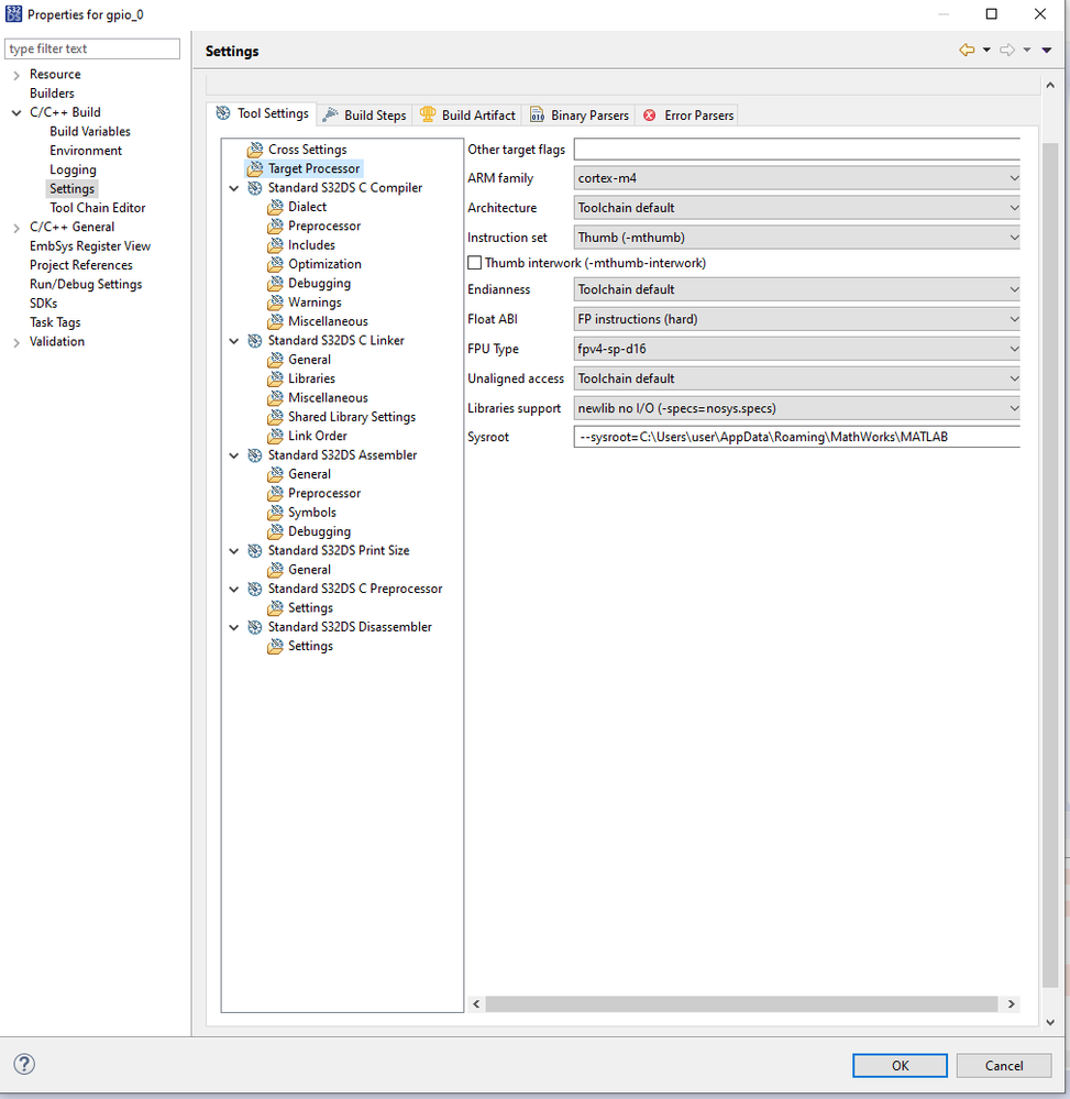

This is a bit strange - could you right click on the project -> Properties then go to C/C++ Build -> Settings -> Target Processor -- from there can you make sure that Libraries support is set to newlib no I/O (-specs=nosys.specs) like in the image below?
Kind regards,
Razvan.
25,433 Views
utkuckmgl
Hello Constantin Razvan Chivu,
Yes it is set. But sysroot is different, I'm not sure if it changes anything to cause errors.

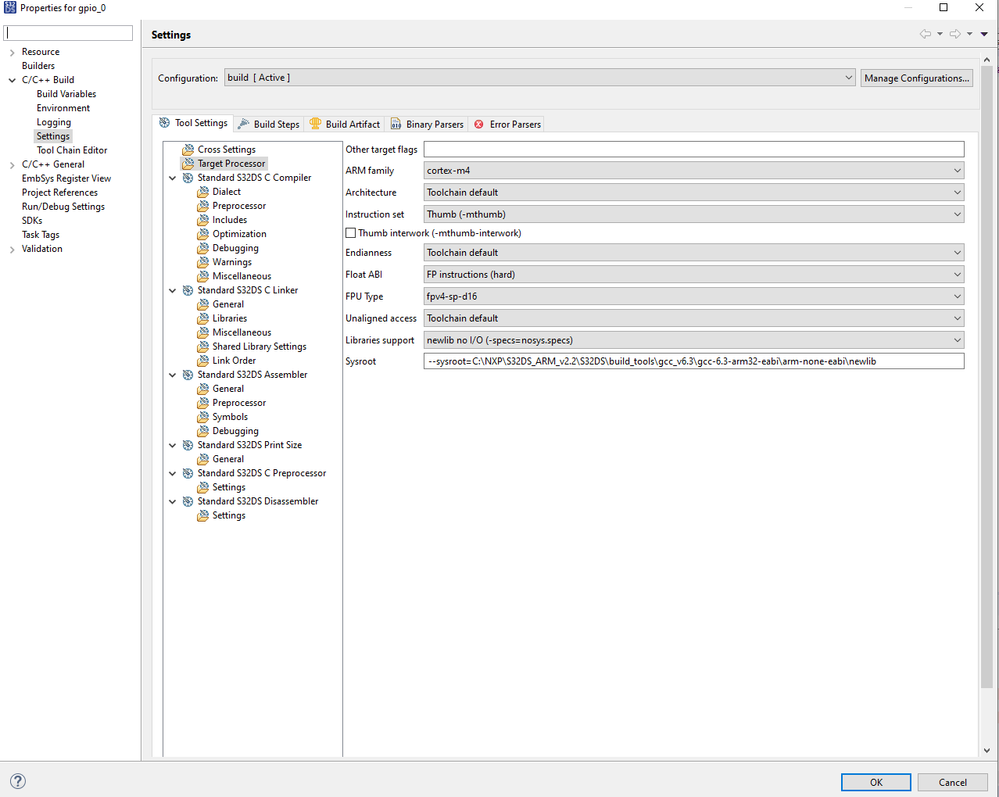

constantinrazva
Hello [email protected] ,
Can you change the sysroot to
"[your_toolbox_root_directory]\tools\gcc-6.3-arm32-eabi/arm-none-eabi/newlib"
and try again?
Kind regards,
Razvan.
25,433 Views
utkuckmgl

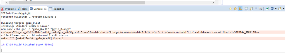

And now errors has gone but I have just 2 more left :smileysad:

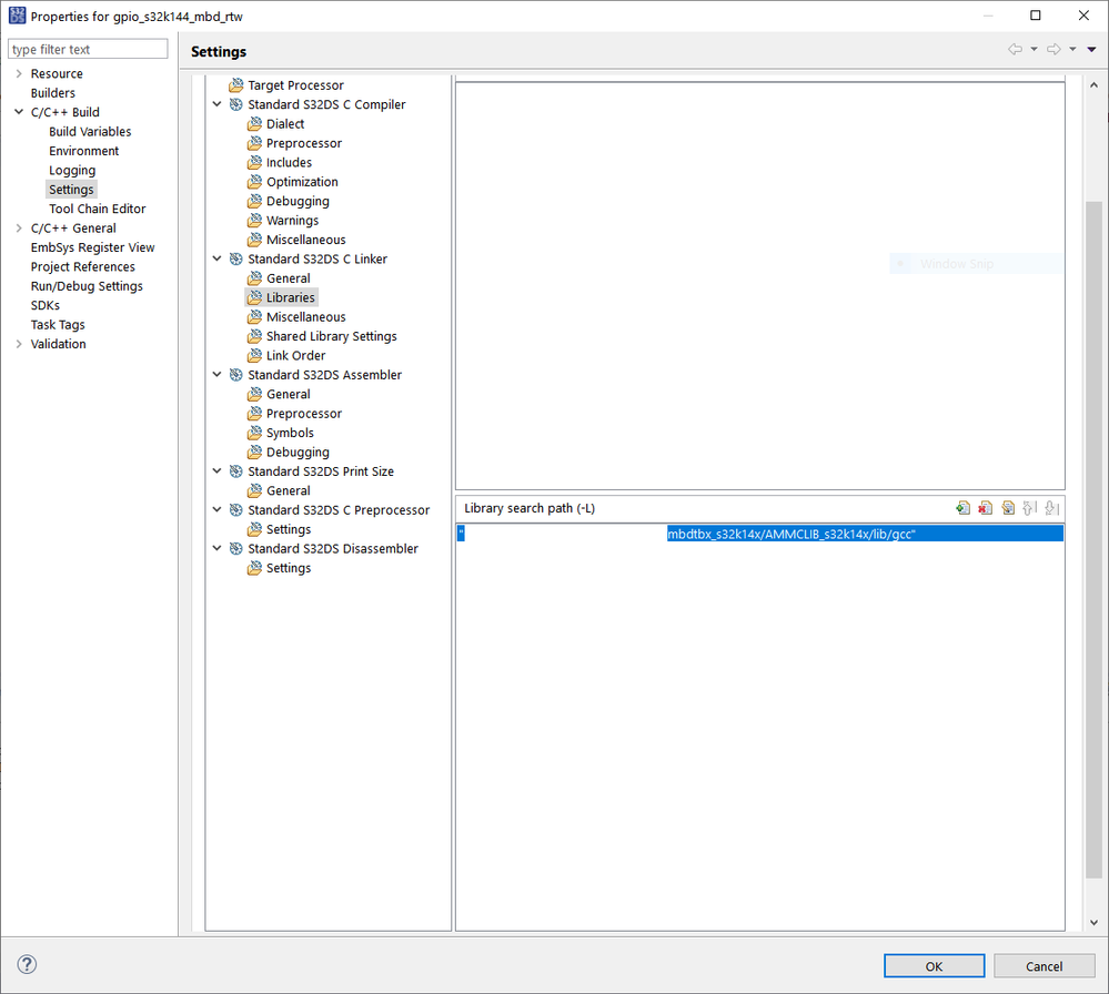

constantinrazva
Can you check to see if you have a correct path in Settings -> Standard S32DS C Linker -> Libraries, under library search path? You should see {TOOLBOX_ROOT}/mbdtbx_s32k14x/AMMCLIB_s32k14x/lib/gcc, like in the image below:
