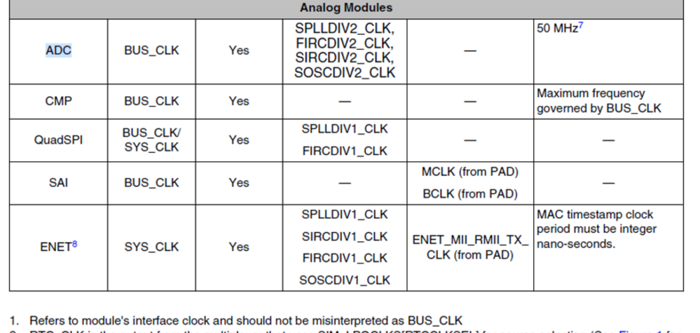

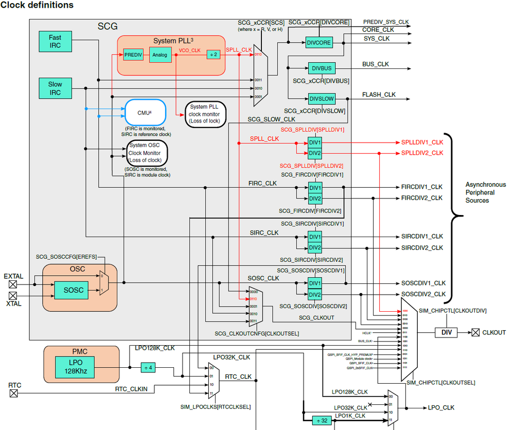

I'm struggling with clocking though so I'm pretty sure that's where the problem is.  According to the data sheet, fadck has a max of 50MHz to operate reliably.  I assume this means I need to scale the 80MHz down to 40MHz but is the PDB_Config the correct place?  According to the help documentation, this prescaler is dividing the peripheral clock (BUS_CLK), not the system clock. I don't know where else I can divide the system clock.  I'm having trouble following the clocking diagram in the ref manual but it looks like I would divide the system clock in the DIVBUS block.  Not sure how to do that with the Simulink Toolbox.  The only place I see for clock division is PDB_Config.
I'm seeing ADC using the BUS_CLK as peripheral clock but Note1 below says not to misinterpret the interface clock as BUS_CLK.  I have no idea what that means:

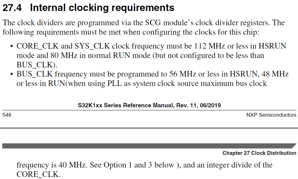

When I look at this section of ref manual, I'm further confused.  My only two options for clock speed are 112 and 80.  Those are both acceptable for HSRUN but only 80 is acceptable for RUN.  Does this mean I'm always using HSRUN or am I switching between HSRUN and RUN by switching from 112 to 80?  How does this affect SYS_CLK/BUS_CLK?

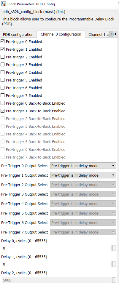

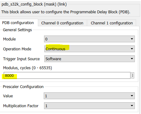

The PDB settings from that model you attached are the following:
1. Operating Mode - Continuous --- this means that once you software triggered this block using the PDB_Start_Soft_Trigger, the PDB will automatically retrigger the signals. So the One-Shot method is more suitable for testing. This means that for the each call of the PDB_Start_Stop_Trigger block, the PDB will perform only one set of triggers. To trigger again, the Start_Stop has to be called again. If you move this block to the step function call, basically each PIT step will provide a start trigger for PDB.
The Modulus represents the top value for the PDB Counter. So once the trigger came, the PDB will count until this value and reset. For this testing purposes, the value must be as low as possible.
In the next tab, the Delay 0 is used like this: once the PDB timer starts to count, when it will match this value, it will trigger the ADC conversion.
So basically, this model is only starting the continuous PDB conversion once and then will perform the conversions at constant time intervals.
Now, what I did in the attached model, I put the start conversion PDB_Start_Soft_Trigger on the step, so basically every PIT0 will start a conversion. I minimized the PDB Modulus and triggers to 0 and basically for every step, the PDB will trigger another conversion.

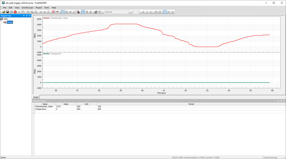

The model I've sent you, disables the second channel trigger in order to convert faster, but on my board, the potentiometer value is still converted fine. This is the FreeMaster screenshot.

It took some time but I have figured out the proper configuration for back-to-back operation so that both ADCs will read in one-shot mode.  I had pre-trigger0 in back-to-back mode which means there was never a first ADC read to kick off the sequence.  I unchecked the box and it now starts when PDB triggers then pre-trigger1 fires as soon as that read is finished.

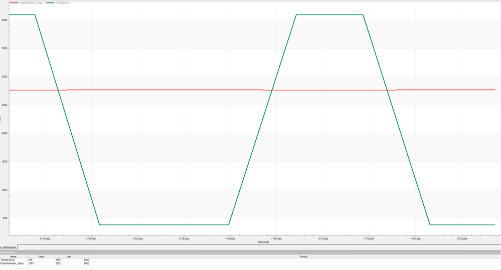

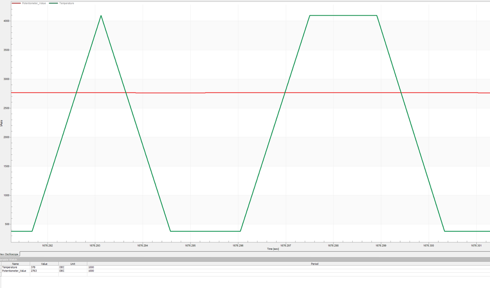

I still have a problem with the ADC read speed.  I can see that the LED is switching at the step_tick timing as expected (on my scope) but the ADC is not matching that speed.  I'm still seeing no faster than 1ms updates on ADC in FreeMASTER.
With step_tick at .001:
With step_tick at .0001:
FreeMaster scope properties:
There must be something simple I'm missing or FreeMASTER just isn't capable of anything below 1ms.

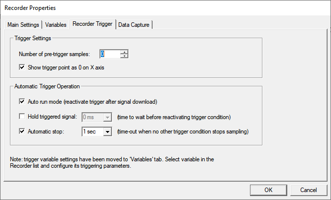

There no much improvement that can be done when scope period is set to 0ms. The only options is to make sure that there are no other ongoing communication between the target and host PC - ex: make sure there a no variables in the "Variables Watch" widget. You can track all the messages in communication log (ToolsCommunication Debug Log...).
In case you need to capture the data around e specific event (trigger) you could use Recorder functionality (see user guide section 4.1.1.3). You can call the "recorder poll" function in a interrupt routine that will store data in an on-board array at specified frequency. Please note that it unlike the scope it is not meant for continuous data polling - FreeMASTER reads recorded data from the board only when the trigger condition is met or a timeout occurs.

Thank you for your reply iulianstan.  ‌I have attempted what you suggested by removing the variable watch and saw no improvement.  I was unable to find the "recorder poll" function but I saw FreeMaster_Poll_Call and FreeMaster_Recorder_Call.  I tried them both to limited success.  I was able to get a sample on the recorder screen but it did not represent the signal it was reading.  Something is breaking when I switch from Scope to Recorder.  Scope is showing a square wave like I posted above then switch to recorder and I get a flatline series of samples that reside somewhere between high and low.  When I switch back to Scope, the signal is stuck flatlined at max value 4095.  I'm able to reset the MCU and the signal returns.

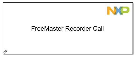

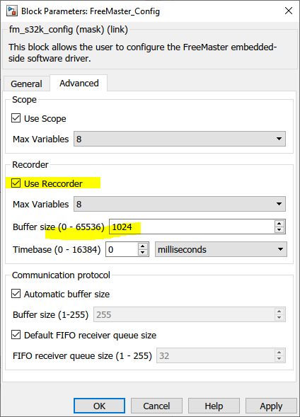

The Freemaster Recorder Call block that must be added in order to achieve this functionality is this one:
Now, the recorder must also be set int he FreeMaste_Config block.

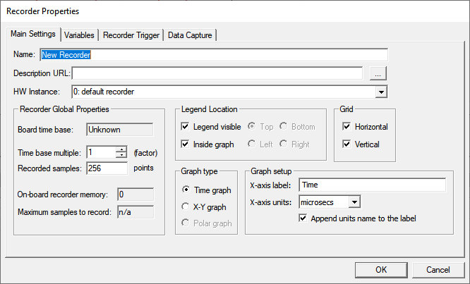

For the FreeMaster application, The maximum allowed samples point is 256, you will see this error.
But what we believe it happens is that the step time is more faster than this recorder transfer has place. And this might be the reason why you get a constant value.
