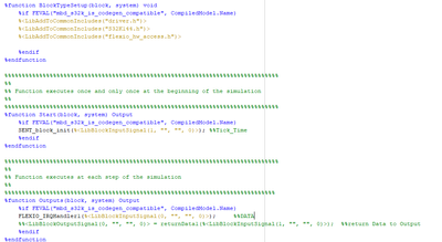

So I updated my code, TLC and Mex file
-> in my code now instead of using
FLEXIO_IRQHandler(FlexIo_IRQN)
i am manualy calling
FLEXIO_IRQHandler1(uint32_t DATA),
this is also updated in TLC file so in tlc ->
%function Outputs(block, system) Output
%if FEVAL("mbd_s32k_is_codegen_compatible", CompiledModel.Name)
FLEXIO_IRQHandler1(%<LibBlockInputSignal(0, "", "", 0)>); %%DATA
%%<LibBlockOutputSignal(0, "", "", 0)> = returnData1(%<LibBlockInputSignal(1, "", "", 0)>); %%return Data to Output
%endif
%endfunction

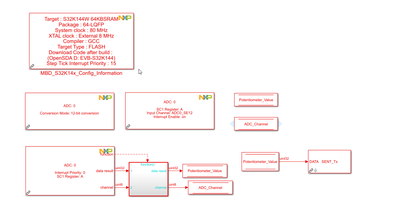

also i am attaching the simulink model ,snapshot of tlc and s function c file with this post
in the model i am taking converted data from adc block and using that data for Transmiting SENT Singnal
The code is working in IAR Debugger (there i have ADC function ) in simulink i am using ADC block for adc conversion
i am initialising the clock and FLEXIO and i am getting this error and i cant seem to understand what i am missing

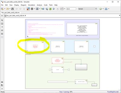

Could you please have a look first at the examples we provide together with our toolbox related to the FlexIO UART, and try one of the examples there on your setup?
For example you could start with fxio_uart_hello_world_s32k14x example
If you are still unable to build your example, and still facing errors, could you please send me your example?
