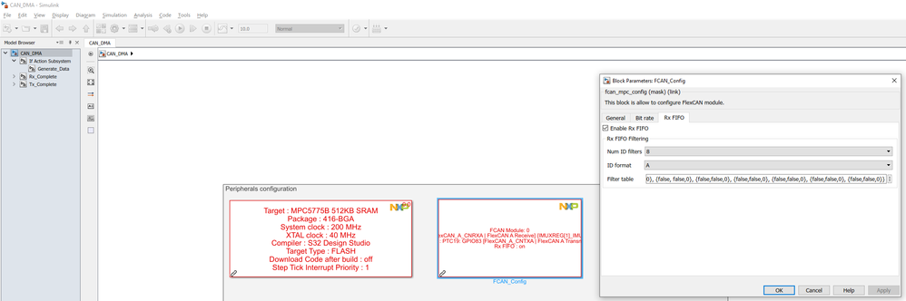

Hi folks,
I have MPC5775B based board.
I want to use Rx FIFO Transfer type to DMA mode instead of interrupt mode for FlexCAN module(or also if possible for MCAN).
I'm working over Matlab generated code.
I setuped simple MPC5775B project and try to use CAN Bus with EDMA feature(I set the FEATURE_CAN_HAS_DMA_ENABLE (1) on MPC5775B_features.h, and compile project without code regeneration)
ı got the compilation error.

flexcan_hw_access.h: In function 'FLEXCAN_SetRxFifoDMA':
flexcan_hw_access.h:1208:31: error: 'CAN_MCR_DMA_MASK' undeclared (first use in this function)
     base->MCR = (base->MCR & ~CAN_MCR_DMA_MASK) | CAN_MCR_DMA(enable? 1UL : 0UL);
flexcan_hw_access.h:1208:31: note: each undeclared identifier is reported only once for each function it appears in
flexcan_hw_access.h:1208:5: warning: implicit declaration of function 'CAN_MCR_DMA' [-Wimplicit-function-declaration]

I also try same configuration on s32 Power Studio i couldn't change the Configuration List "RX FIFO Transfer type" Using Interrupts to Using DMA.
when i insert the below code on the MPC5775B.h within CAN MCR macros
#define CAN_MCR_DMA_MASK                         0x8000u
#define CAN_MCR_DMA_SHIFT                        15u
#define CAN_MCR_DMA_WIDTH                        1u
#define CAN_MCR_DMA(x)                           (((uint32_t)(((uint32_t)(x))<<CAN_MCR_DMA_SHIFT))&CAN_MCR_DMA_MASK)
The error is disappear, but i'm not sure this is proper way to use DMA with FlexCAN
How can i use DMA mode instead of interrupts mode for MBDT based MPC5775B projects?
