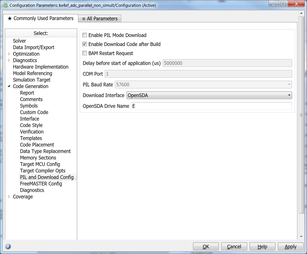

Hi lethuer‌,
It seems that the elf and the corresponding mot files have been created successful - therefore is not an issue with the compiler toolchain.
In general the " Can't download the file to the board." appears when the communication with the board is not set correctly: protocol or/and port/drive letter
Only if i mess up the communication ports i could reproduce your issue:
COPY CATCH: Error using fileattrib
The system cannot find the path specified.
Let me know if you have managed to fix it by double checking your connection to the board settings.
Hope this helps!

I've checked the configuration again and it is like yours.
Anyway I guess the Bitlocker on my System could be the reason.
If the hardware is connected, then our Bitlocker encryption appears due to the mass storage.
But I can't carry out and thus in the end of a Windows 7 computer I only have read permission.
Could that be the reason ?

Yes, that's most likely be the culprit. I guess the bitlocker is disabling the mass storage. Without the mass storage mapped in your system there is no way for the toolbox to copy the mot file to the destination - hence the error.
Can you address this limitation with your IT department ?
