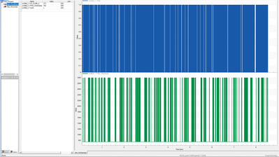

When the model operates with multitasking and the FTM-Block is polled at either 0.0001 or 0.00001s, it generates the data below:

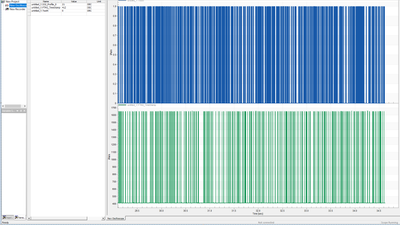

When the model is operating in single task operation at 0.0001:
And in single task operation at 0.00001:

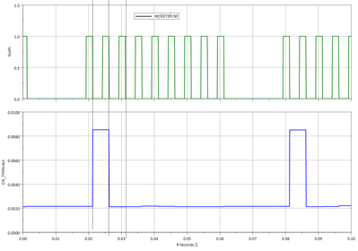

Analysis has shown that the generated signal for the FTM is correct.  The timing between the output and the FTM-Timestamp align, but the values don't correlate.

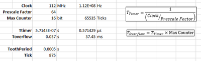

As an additional point, I'm expecting to measure ~875 Ticks:
