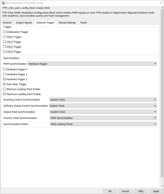

I would like to re-initialize my FTM counter when using wither of the harware trigger 0, 1, or 2 using the MBDT toolbox in simulink. For example, I would like to an LPIT1 to enable FTM harware trigger which would intern reset my FTM counter. I have configured my FTM in the following manner:
Since, I have enabled hardware trigger 2. I send a logic-1 to the FTM_FLT0 PIN (PTE7/PTA17 pins). When I flash on to my S32K144EVB I do not see any PWM signals.
I would lilke to know what I am doing wrong.
