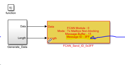

Hello everyone!
I'm doing some tests with Model-Base tool from S32K144, using CAN communication.
I noticed the FCAN_Send block have as input Data and Lenght. Is it possible to set Message ID as an Input instead of block configuration?
If this is possible I can use only one block, instead of 20 with different IDs.
Best!

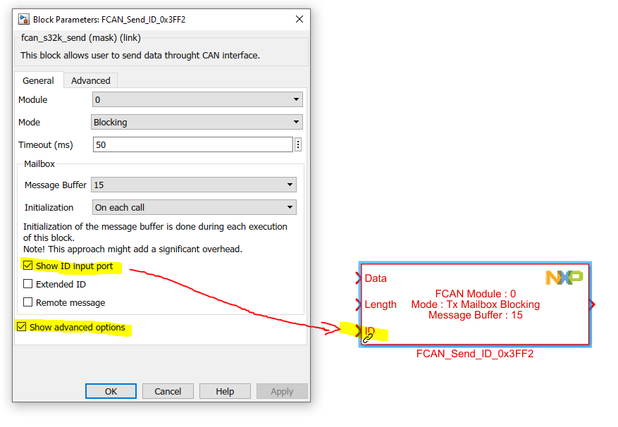

mariuslucianand
Hello @Pullo,
This functionality of having the Message ID as input for the CAN Send Block has been added to the Model-Based Design Toolbox for S32K1xx and it is available in the latest 4.3.0 version. In order to enable the ID as an input port, you have to check "Show advanced options" and then check the "Show ID input port" as shown in the image below.
Hope this helps,
Marius
