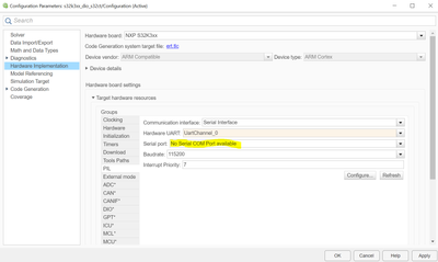

Also under Hardware Implementation --> Target Hardware Resources --> PIL
I am unable to find a serial port in the drop down. Is this the issue? If so why is it not happening with the Dio example?(even there I am unable to find a serial port) but still the code gets flashed into the hardware.

Hardware: Please connect an USB cable between the host PC and the USB2Serial converter on the EVB. In case your EVB does not have an USB2Serial please let us know if more details are required.
Software: After making this connection press the refresh button under Hardware Implementation --> Target Hardware Resources --> PIL group and select the COM Port as identified inside Device Manager under the Ports tab on your PC.
Since for a simple application deployment, as already mentioned at point 1, there is no need to establish a serial connection, these settings should be made only in case of PiL (that's why Dio example works with no issues).

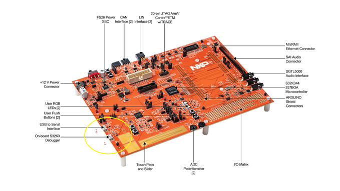

For the PiL example mentioned above, you are using the internal configuration tool, S32CT, and a default configuration project for S32K344-Q257. In this pre-configured project that we are providing, the Uart component has two channels configured (UartChannel_0 and UartChannel_1). UartChannel_0 configures the LPUART6 instance on the board and UartChannel_1 corresponds to LPUART13.
LPUART6 is routed to the EVB's OpenSDA chip. The MCU's LPUART13 instance is connected to ChannelB of the USB2Serial converter on the EVB. When you connect the board to the PC via the USB2Serial port, DeviceManager will display two COM ports for both FTDI channels; typically, the higher COM port number corresponds to our LPUART13 instance (it depends on how Windows assigns COM port numbers).
In the following picture, you can see both the OpenSDA(1) and USB2Serial(2) ports on my S32K344-Q257 EVB revision:
In conclusion, if you are using the dedicated USB2Serial converter of the EVB, you should select UartChannel_1 inside both models' settings and start with the highest COM port number in the list. In order to successfully establish serial communication, you should check your schematic and make the necessary adjustments in the configuration project if your EVB has a different USB2Serial converter or a different board revision.

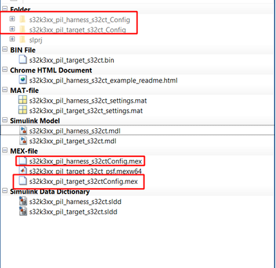

  1. Clear our default project files like  <model_name>_Config folder and the <model_name>_Config.mex configuration file as shown in the image below.georgevictor_0-1682580429649.pnggeorgevictor_0-1682580429649.png
  1. Clear also the .sldd and .mat files generated by our toolbox for the model.

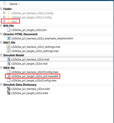

  2. Clear the files generated by the PiL simulation like slprj folder, <model_name>.mexw64 file.
Sometimes, in order to delete these folders or files, you must first remove them from the Matlab path. Run 'clear mex' in Command Window to remove the.mexw64 file from the path.
My recommendation is to clean the Simulink-generated files mentioned at step 3 each time you run a new simulation.
After the cleanup is finished, open both models (a fresh default project s32k3xx_pil_target_s32ctConfig.mex and a Config folder is brought next to the model for the Hardware part selected in the model). In the Hardware Setting of the models, selected the desired Hardware part package if needed. Under Hardware Implementation --> Target Hardware Resources --> PIL press the refresh button after you have connected the usb cable to the EVB, select the COM port, select the UartChannel (UartChannel_1 if you are using the dedicated USB2Serial converter of the EVB) and press the Apply button. Don’t forget to save the models after making these changes.
