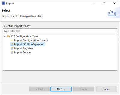

Then you can open the S32 Configuration Tool and select Import:

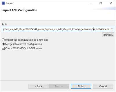

Then you can select the previously generated Adc.epc file:

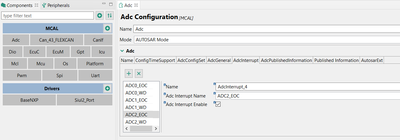

Then open and check all settings in the ADC tab of S32 Configuration Tool:
I have attached ouput.zip file with all epc files from the s32k344_pwm_trgmux_lcu_adc_ctu_ebt project.
Let me know if this works,
