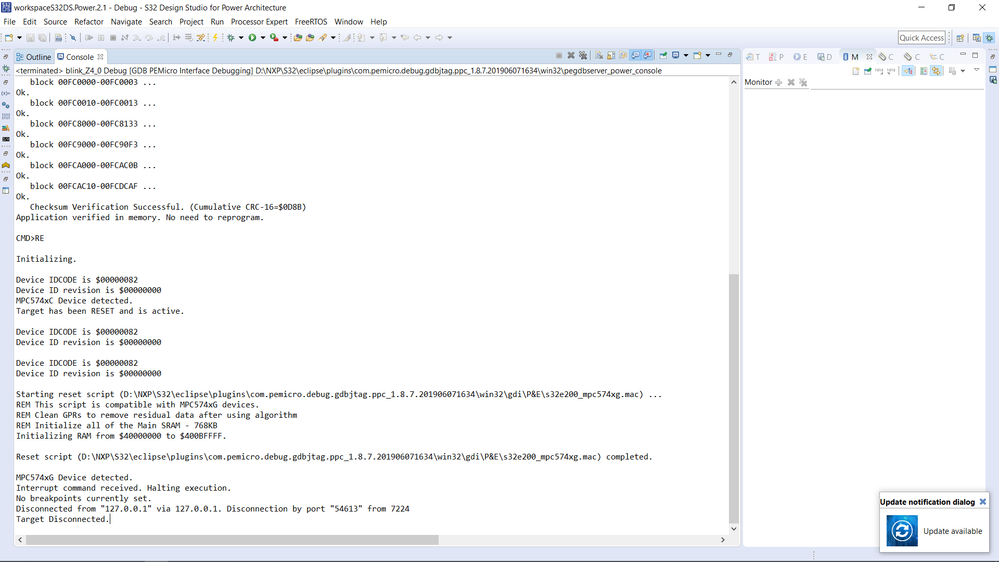

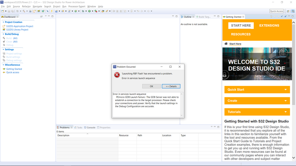

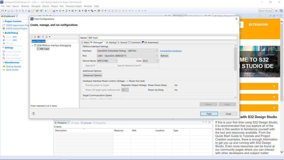

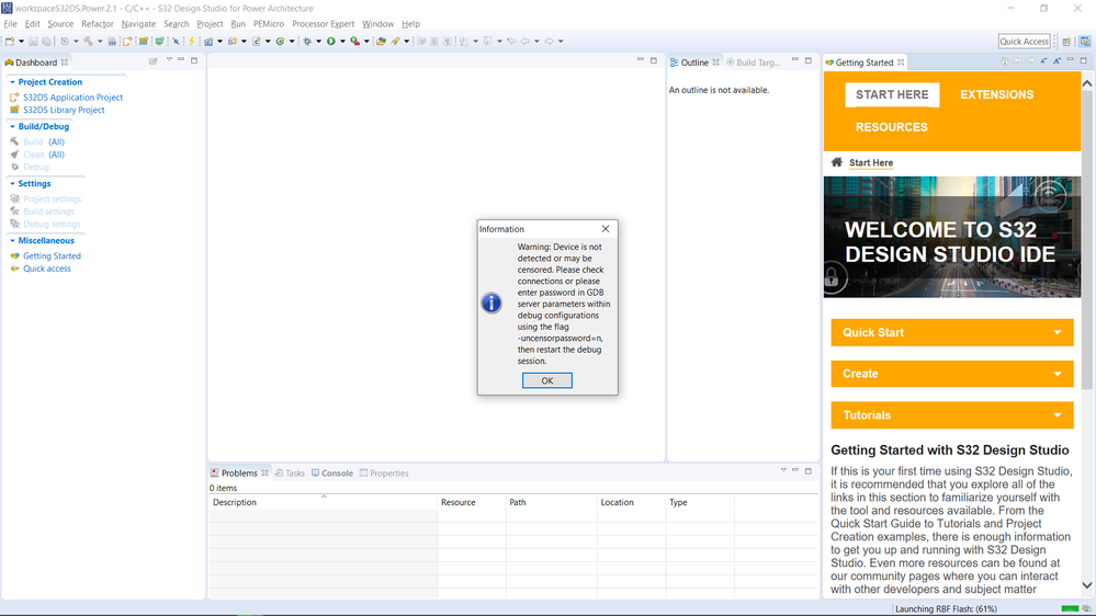

I follow Model Based Design Toolbox MPC57xx Series Quick Guide .In Bootloader Setup ,I used S32DS.POWER.2.1 to flash bootloader but it showed Device is not detected or may be censored then i follow this uncensorpassword  but nothing change it has same problem.

I’m very sorry I have troubled you.Screenshot (279).pngScreenshot (278).pngScreenshot (277).pngScreenshot (276).pngIMG_20200704_145330.jpg

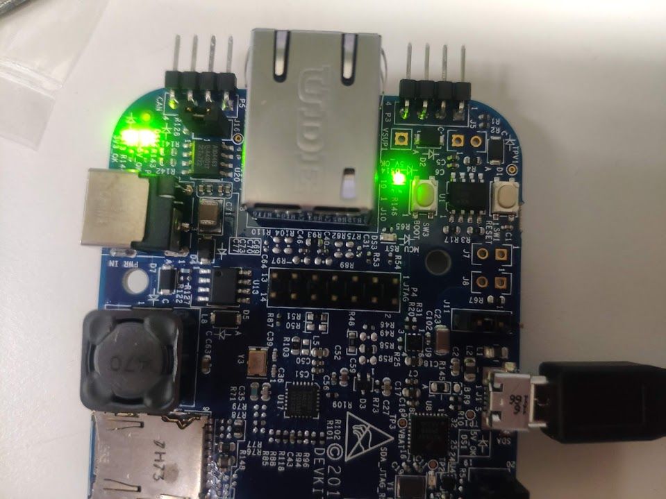

Hello 60010001@kmitl.ac.th‌,
Can you please attach an image with the board connected to the PC? I am interested in which LEDs are lighting and how the jumpers are set.

60010001

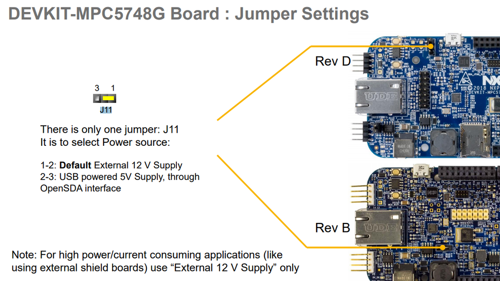

In this question,I forgot to change J11 to 2,3
but when i changed J11 to 2,3 i have this problem

mariuslucianand
It seems there are two revisions for the MPC5748G board: reb B and rev D. From the images you have attached I see that you own the rev D.
Anyway, basically the J11 sets the power source and if you try to power the board only for the computer, then you have to set it on the position 2-3. The two LEDs that are turned on, specifies that the voltages 3V3 and 5V are ok.
 https://www.nxp.com/docs/en/quick-reference-guide/DEVKIT-MPC5748G-QSG.pdf
Leave it on the position 2-3 if you are only powering the board over the uUSB and try flashing the bootloader on the board. The target seems to be detected now so please, retry a Simulink model over the PC8 and PC8 of the LinFlex2 serial.
Hope this helps,
Marius

60010001

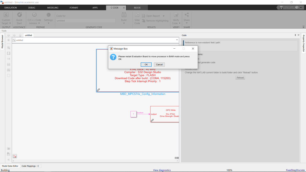

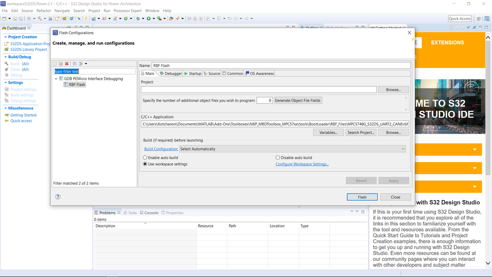

I use embedded coder for build code to the board but it occur like this

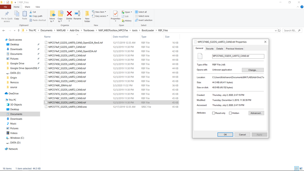

before this i try to flash bootloader with this file
