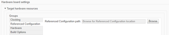

The configuration attached, from my knowledge, does nothing with my model. I am simply attempting to turn on the LEDs and keep them on. I started with an example configuration, added my pins, and deleted the ones I was not using (deleted PWMs, CAN, SPI, etc as I have other pins connected to hardware on this PCB... relays were cycling at a very high frequency so I tried my best to remove them).
After hours of fixing errors related to the things I deleted, I can build my model and flash the board. The board has a very faint buzzing sound (nothing like the relays) which makes me think something unintended is occurring. The LEDs do not turn on. I have looked around the hardware settings, configuration settings, model settings, and the simulink blocks and I have run out of ideas.

First of all, the fact that your configuration with the model name is no longer generated is because you tried to use the referenced configuration functionality. This is a more complex functionality that allows you to share a configuration with multiple models (more details here). But this is not your case.  To reset the location to the default value, please run the attached restoreRefConfigLocation.p script, by right-clicking and running, when you have the Simulink model open. This way you will have the default value and you will no longer use this functionality.
