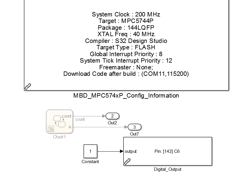

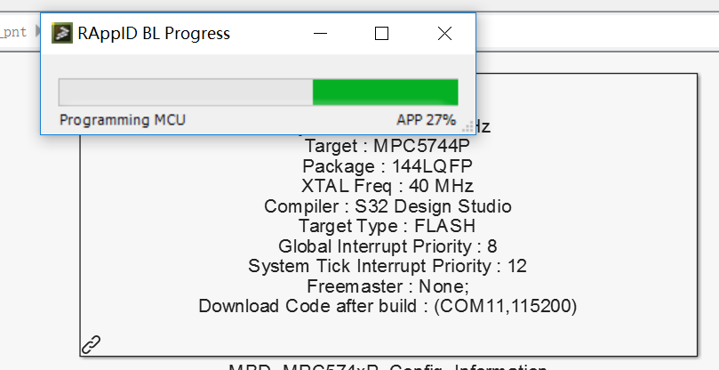

I use the model in the toolbox, as shown in the attachment. I configured the PTC6 pin to output high,and use the RAppID tool to successfully download the code to the board.But the PTC pin voltage is close to 0V.I also tested on the devkit board, there are similar problem.pastedImage_1.pngpastedImage_2.png

I presume you are using S32 Design Studio v1.2. If that is the case, then please apply this patch: https://community.nxp.com/thread/451804#comment-916493 (HotFix_3: Add support for the latest e200 compiler that is released with S32 Design Studio for Power v1.2 ) on top of mbdtbx_MPC574xP
When using the S32DS v1.2 the startup sequence has been changed therefore you need the patch to generated the correct code.
Please use the project attached to confirm it works ok. The RED led should blink at each 1sec.
