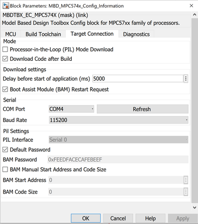

My solution is using "Download code after build" option in MCU configuration block, but it works only once. Therefore, I use following steps:
1. Flash MCU via Multilink (any image)
2. Generate and build new code which uses flexcan by Simulink and MBDT with "Download code after build" setting
3. Before next build with flexcan flash MCU via Multilink
OR
To use Multilink for all test builds and use "Download code after build" option for release version.

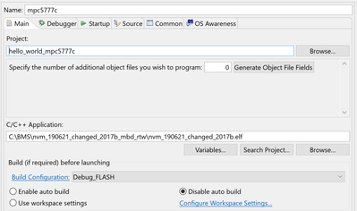

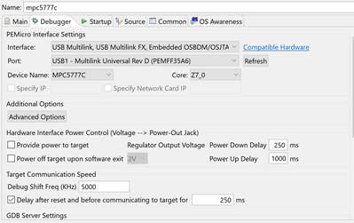

In my case I try to download generated elf file using Multilink with these settings:
and after reset the code is not working.
In same time when I choose option "Download code after build" and use the RappId Bootloader, I am not facing same issue.

I guess the root cause is somewhere in code generation settings. When I selected "Download Code after build" option and used COM port to flash MCU, after reset code works fine. Then I have used elf file from this build to flash MCU again with using Multilink and code works fine again even after reset.
