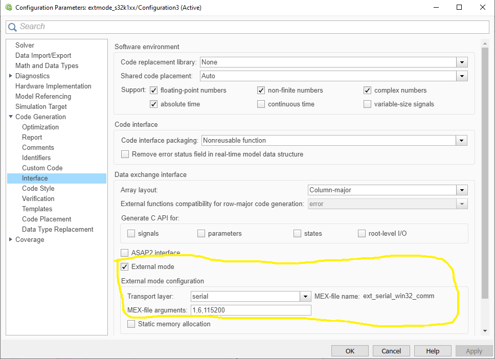

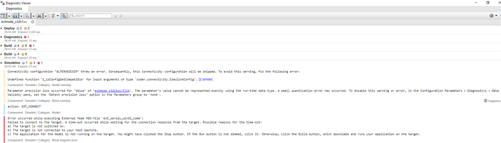

Hello @mariuslucianand
I have done exactly the steps shown on the link. When I clicked "Build for Monitoring", no problem application compiles and runs on the MCU, however when I click on Control Panel -> Connect I get this error: Untitled1.png
Also my configuration is:
So what is the problem?
