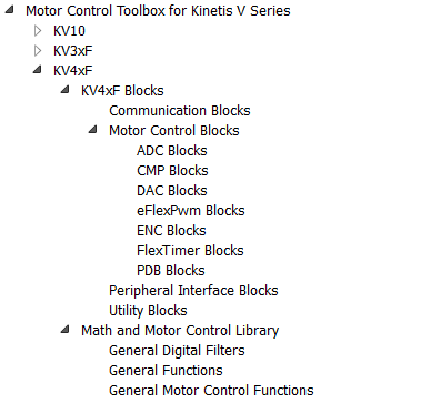

Hello dumitru-daniel.popa‌
The Simulink blocks keeps a similar look-and-feel, but there might be different options due to IP differences.

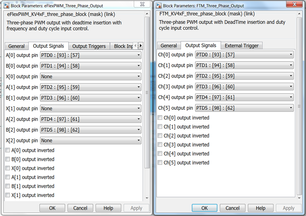

the KV4x library also has a "FTM_Three_Phase Output" block.
So could you explain why I should use FTM_Three_Phase_Output or eFlexPWM_Three_Phase_Output ?

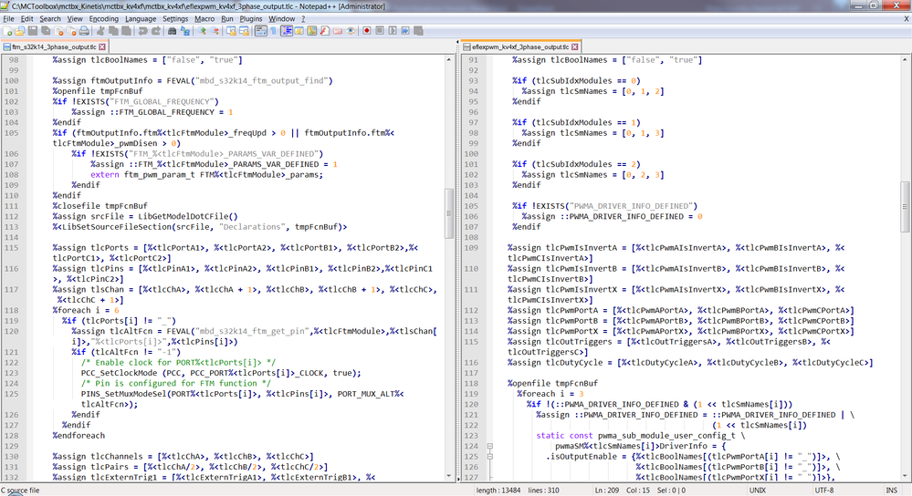

Even if Kinetis and S32K microprocessors share the same ARM Core and similar peripherals - they belongs to tow different toolboxes that complicates the things. In this case there are 2 different SDKs with different drivers and initialization structures that are used to generate the code. If you check the TLC associated with each of the block you will see those differences:
Therefore, as general rule - use only the Simulink blocks that are exposed by each Toolbox Simulink Library: if you use a Kinetis microprocessor then use only the ones from Kinetis V Series Simulink Toolbox

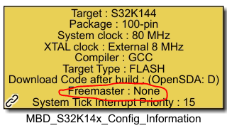

In your original Module5 model you didn't have activated Freemaster in the s32k_config

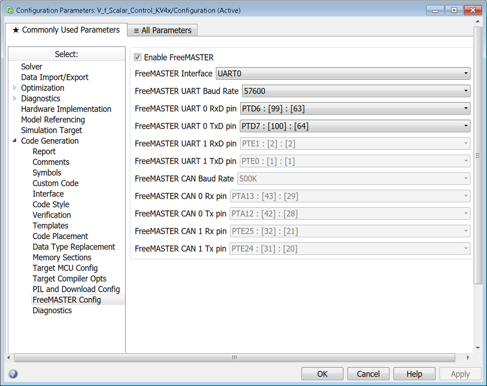

So this is not necessary if I use the „freemaster_data_recorder“ from Kv4x library or should I activate Freemaster also in the MCD_MKV4x config block like below ?
What influences this Option has ?
I'm using the S32K toolbox revision 3.0.0 which has a dedicated FreeMASTER configuration block.
For KV4 you have to use the FreeMASTER configuration from the main configuration block as you have shown above.
