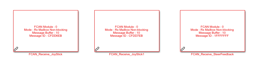

I am working with a S32K144 using Simulink & the new toolbox (R2018), I can send messages on the bus, however I am having difficulty reading from the bus. I have tried the CAN example model, but the light seems to blink even if I don't send the CAN message so it hasn't been very helpful for troubleshooting. On my project I implemented the same receive format and I am using FreeMASTER to check the variables, but the messages aren't being received. I have attached my model below, it just receives messages from a joystick and sends out one steering command. Please let me know if you guys have any suggestions.

gramirezv
Hola [email protected]‌,
I think the problem you may be seeing is because you have to include the receive blocks inside the CANReceive\RX_Complete block also.
These blocks are the same you're using on the init block (the one that runs only once on startup with the init_flag), this block setup your initial CAN Receive messages and then you have to include your receive blocks every time a CAN message has been received. So, when the FCAN_Rx_Complete_Isr calls your Rx_Complete block you are able to receive the subsequent CAN messages.

constantinrazva
Hello [email protected],
It seems that  gramirezv‌ has spot this other issue before I did. Thank you for that Gustavo! He is right - you have to call the CAN Receive blocks inside the ISR calls, so you can continue receiving other CAN messages.

fernando_barrio
Hi ‌constantinrazvan.chivu and gramirezv,
I appreciate your suggestions I have added all three of the FCAN receive blocks into the CANReceive\RX_Complete block and also into each case block. However, I am still not able to see any content being received by the NXP, but I can see it with a Vector CAN tool. Do you guys have any other suggestions that may not be allowing me to see anything? I have simplified the model a bit for testing purposes with no luck.

constantinrazva
Hello [email protected]‌,
I think you are facing some issues because you are using extended ID. We fixed this in a previous thread, but just now created a page dedicated to S32K14x 2018.R1 hotfixes - you can find it here.
Please follow the steps for hotfix 1 - this should fix your problems. Please let us know if you are having other issues.
