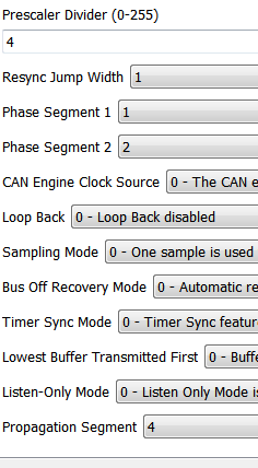

Futhermore, I tried to make CAN working using Model based motor control toolbox and I failed to make it work.
I configured according to datasheet but still not CAN communication.
I want to configure both CAN channels:
1) 500 kbits
2) 1 Mbps
Can you please help me on how to configure the CAN configuratio block to make it work.
Ali

alimeraj
I made the can work on CH2 @ 500kbits but I still couldn't make it work on CH 1 and I havent tried on CH 0.
Now I am trying to configure CH2 for 1Mbps but I cant work out the RJW,Seg1,Seg2, prop and pre div.
what I have in our base software is bit different.
Can you please provide me with a method to calculate the right values for any given baud rate.
Ali

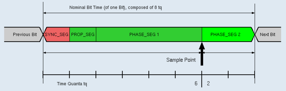

constantinrazva
hi alimeraj‌,
SYNC_SEG is 1 Time Quantum long -  it is used to synchronize the various bus nodes  -it's non-programmable.
PROP_SEG is programmable - it is used to compensate for signal delays across the network.
PHASE_SEG1 is programmable - it is used to compensate for edge phase errors and may be lengthened during resynchronization.
PHASE_SEG2 (Seg 2) is used to compensate edge phase errors and may be shortened during resynchronization. For this the minimum value of PHASE_SEG2 is the value of SJW.
SJW is the Synchronization Jump Width.
Here are configurations for 1Mbps and 500Kbps (for CLKSRC=0, meaning the CAN engine clock source is the oscillator clock) for devkit/eval board.
1Mbps:
PRESDIV - 1
RJW - 3
PSEG1 - 5
PSEG2 - 5
PROPSEG - 6
500kbps:
PRESDIV - 3
RJW - 3
PSEG1 - 5
PSEG2 - 5
PROPSEG - 6
Please let us know if it works. Hope this helps!
