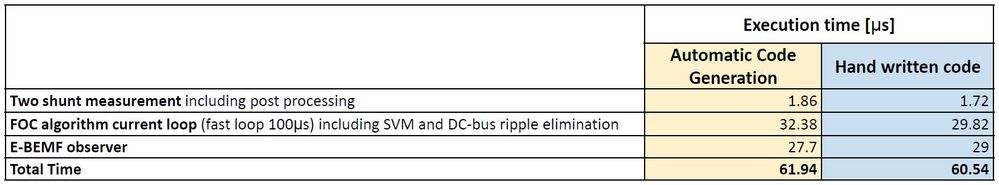

I've received a lot of questions lately about how the performance of the automatic code generation from Matlab versus the hand written code.
So, how good is the generated code?
Here is a comparison:
For more details have a look at the document attached.
Hope this helps you taking the correct decision. If you have questions and comments leave a reply below.
