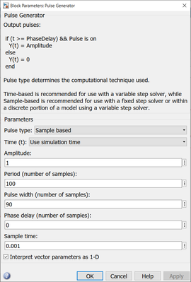

Hi all, I have obviously been adding logic as my model progresses and I have now suddenly had it make everything 50% slower.
For example, this 100ms trigger has always sent the CAN transmit block inside at 100ms. It is now sending at 150ms. This is happening to the whole model now, everything is 50% slower (Even tasks with sample rate of 1s are 50% slower)
100ms trigger block:
In other uC's I've used in Simulink before I have seen issues like this when program memory is nearly full, Is there anything the reports back how much program or data memory has been used after a build like Microchip's blockset does?
I am hoping the memory isn't the issue because there is not much logic in at all yet and will be over double it's current state when finished.

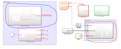

Can you please have a quick look at my simplified model that still produces the fault I am seeing (CAN runs at 150ms not 100ms)?
If I have one of either of these blocks commented out then it runs at the correct rate (100ms):
Is there a better way of doing what I am trying to do? The box on the left I need to receive 96 CAN messages every 100ms on CAN2 (They are staggered and not all at once) and then the right subsystem I need to transmit 16 CAN message on CAN2 every 100ms as well. In my main model I also have 8 messages being sent at 100ms on CAN0 and duplicated onto CAN1.
Will appreciate any feedback on this as it currently has me completely stuck with a short deadline, thank you!
