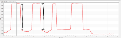

I am working with S32K344, and configuring the board on S32CT with MBDT1.3. I am facing a major issue with the ADC values jumping when i attach a potentiometer. I am attaching an image for the same below:
Here, the jump that you are seeing in black is for the last volts in the potentiometer (about 90% throttle press). i am not able to understand why is this happening. Can someone please guide me on this?

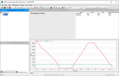

Using the s32k3xx_adc_single_read_s32ct model, the FreeMaster reading is good, using the onboard potentiometer of the S32K3X4EVB-Q172 board:
