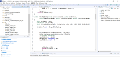

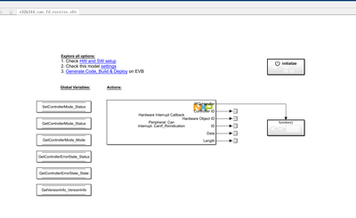

I use the MBD case model provided by the official,C code was generated and compiled and written in S32DS software. All the processes were successful. But why did I use other CAN nodes to transmit messages to the development board but failed.Can you help me!

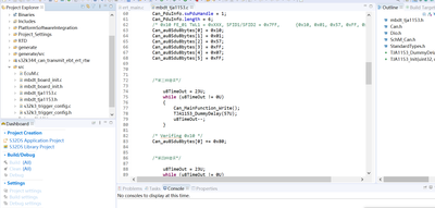

Because the blue light is always on after programming, I judged that there is a problem with the modules TJA1153_Init.So I modified the code in the file mbdt_tja1153 and deleted part of the code, assuming there is no problem, the operation is successful.Is this what is the reason?
