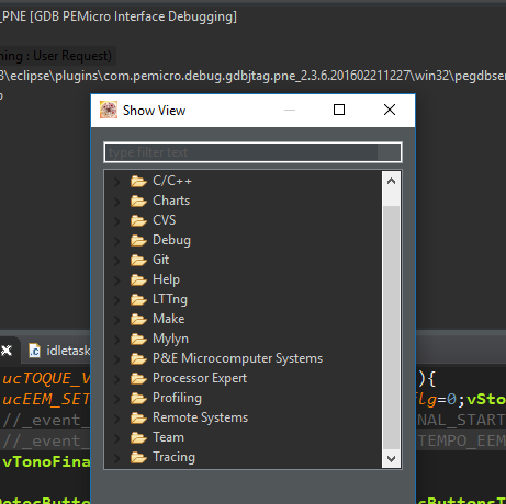

Hi Engineers, i am trying to access at MQX tab, i have configured like is on comutity but something is wrong.
thanks for your help

Hi Jonny:
Did you install the MQX in the default folder?
C:\Freescale\Freescale_MQX_4_2
If you installed it in some other folder, the MQX TAD tab may not shown.
