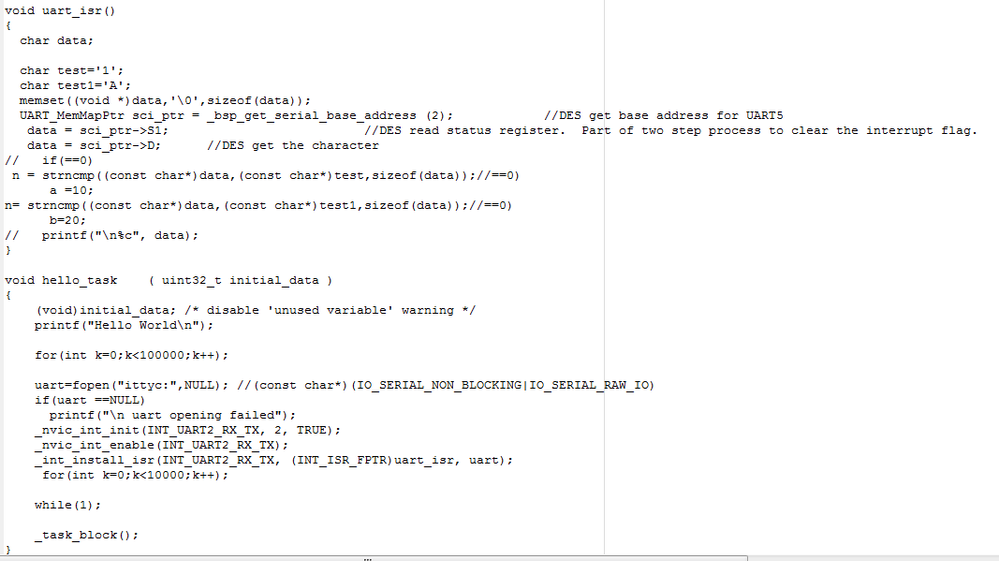

I am using UART for communicating with a BLE module. The end application has power limitations, because of which I want the device to wake up on UART interrupt (if it is in LLS)  and process the data received. Whenever data comes through UART lines, I should be able to parse the data.I am still having doubts..Can you please clarify these for me...
  1. When I am using fgetc(), I am getting the value displayed (I am not using fputc,printf or anything ) in realterm. fgetc() is used to get value from terminal and not to display it. Am I wrong?
  2. Even if BSP is configured for interrupt mode, Do we have to open the handle for UART? Is It a must?
  3. I tried installing a new ISR and setting an event flag in the ISR whenever data is received using the following code snippet. Is it the right way?
    1. But in this approach, if I call printf() after installing ISR, code gets stuck. In TASK Summary no error is showing. Is the ISR mapping section wrong in the code. If I insert a delay after the installation, it works at times. Not always. Even In ISR, if I give printf() it doesn't come out of the ISR, it keeps on looping in ISR
  5. For the end application, I tried the following but no luck
    • Enabled iityc in user_config. Didn't map a new ISR. Tried with the uart_rx_tx_isr() in bsp. I am getting data in the variable if I am doing it using fstatus and fgetc(). But I can't keep on waiting in a while(1) loop. So thought about  task blocking on events and waking up from LLS when UART event gets set. But since ISR is inside BSP, can I set event there? But anyways it won't be accessible as far as the application is considered
    • The next approach was  to use a new ISR and set event in that as the code attached as image. But there also some issues
    • The device wakes up when UART event comes, But I need an ISR which can be controlled by the user. That is the reason behind the second approach . I am not sure if this is the right approach

DavidS
Hi Annamol,
Quick reply with more tomorrow.
Please note the low power example has ability to wake system up using UART so please review the application and associated PDF:
Never call printf() from an isr.  You never want to call functions that might block and/or take a long time to execute.  This is why in my code example I was grabbing the UART data and storing it off into data[] buffer so I could halt application after having sent a bunch of characters to review in variable window and never tried to add code to the isr.  Although you can set event masks and post semiphore or mutex but not wait on them.
To read on this topic look at:
C:\Freescale\Freescale_MQX_4_2\doc\mqx\MQX_User_Guide.pdf
2.23 Interrupt and Exception Handling
3.9 Handling Interrupts and Exceptions
3.9.3.1 Functions That the ISR Cannot Call
David
4,587 Views
annamol
Thanks for the support. got it working with events and storing it onto buffer and using it for later processing :smileyhappy:
