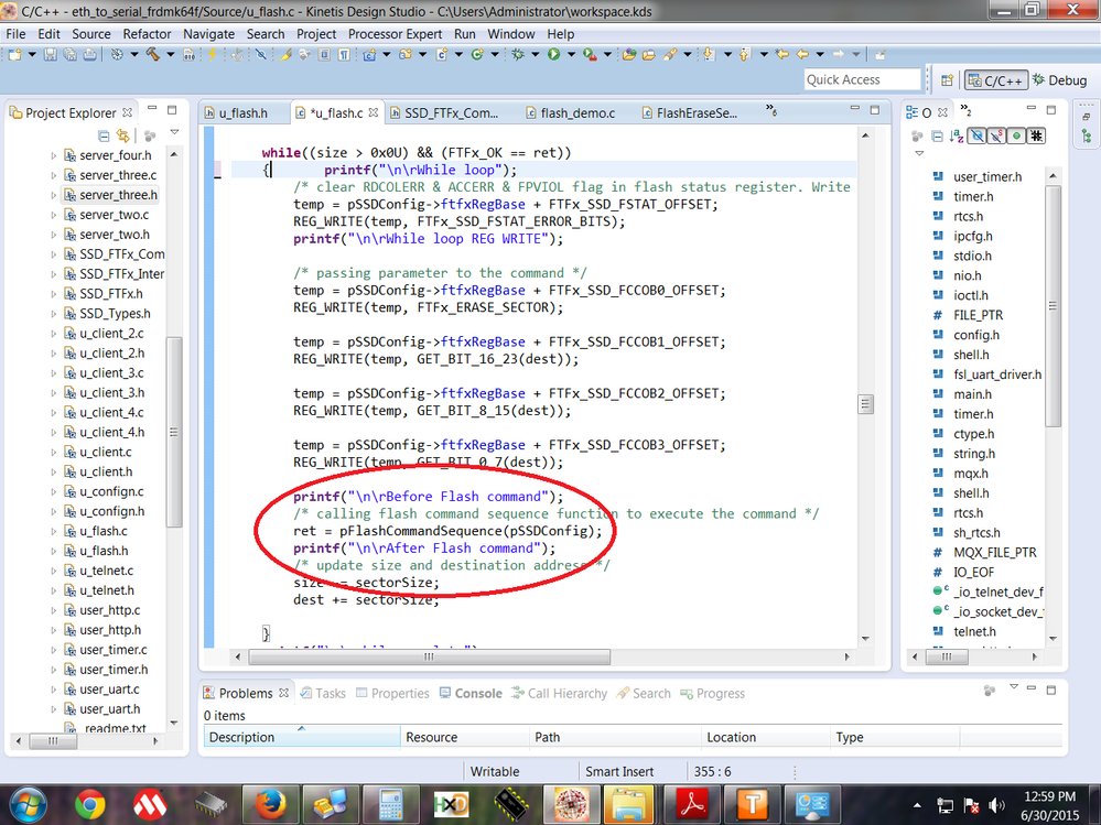

     i am using FRDMK64f120 controller. i am using KDS2.0 and ksdk 1.1.0. MQX. i tried internal flash read/write program. its working fine. after i interfaced flash Demo project into ethernet_to_serial project,now  i am getting some error i dnt know what problem. if i reduce my code size its working fine. if i increase my code size its not working fine.
          in my code i am using more "const char * static_array[ ]" is any problem? because if i comment some "const char * " (its mean reduce some parameter(data)) at that time its working fine. in internal flash i am saving 200 or 500byte data only. at address 0xfa000
text data  bss  dec  hex    filename
528504 2884      23912     555300      87924    eth_to_serial.elf
this is my code size .BIN file size was nearly 519KB.
what is the solution for this? is i want to change any internal flash writing address?  i am not get any idea give some solution.

Hi Sudhakar,
I was able to integrate eth_to_serial example with flash_demo using KSDK1.2 and KDS3.0. You can find it attached.
At the beginning I had problems because application was returning to the flash_demo start (not resetting) and I thought it was because of stack. But at the end the problem was that is is required to disable interrupts. You can see the following code in demo.c.
_int_disable();
flash_main();
_int_enable();

sudhakarp
Contributor V
     i find exactly where my code was hanging. i added image just see and give some solution.
inside FlashEraseSector() API function one while loop there, here my code was looping.Untitled.png
so i debug through serial its outing only "Before flash command" its not outing "After flash command"
string.
