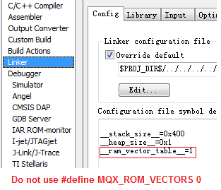

"_int_install_kernel_isr" will install the desire ISR directory to the vector table.  Please use  __ram_vector_table__ = 1,  this is use to tell MQX that the vectors will be on RAM, making possible to change the Kernel ISR.
Regarding the register saving, the compiler will do this for you, you need to tell it that the function you are writing is an ISR with the __declspec(interrupt:0), for instance:
__declpsec(interrupt:0) void myISR(void)

If you are using traditional MQX , please use #define MQX_ROM_VECTORS 0
If you are using MQX for KSDK, please use __ram_vector_table__ = 1
