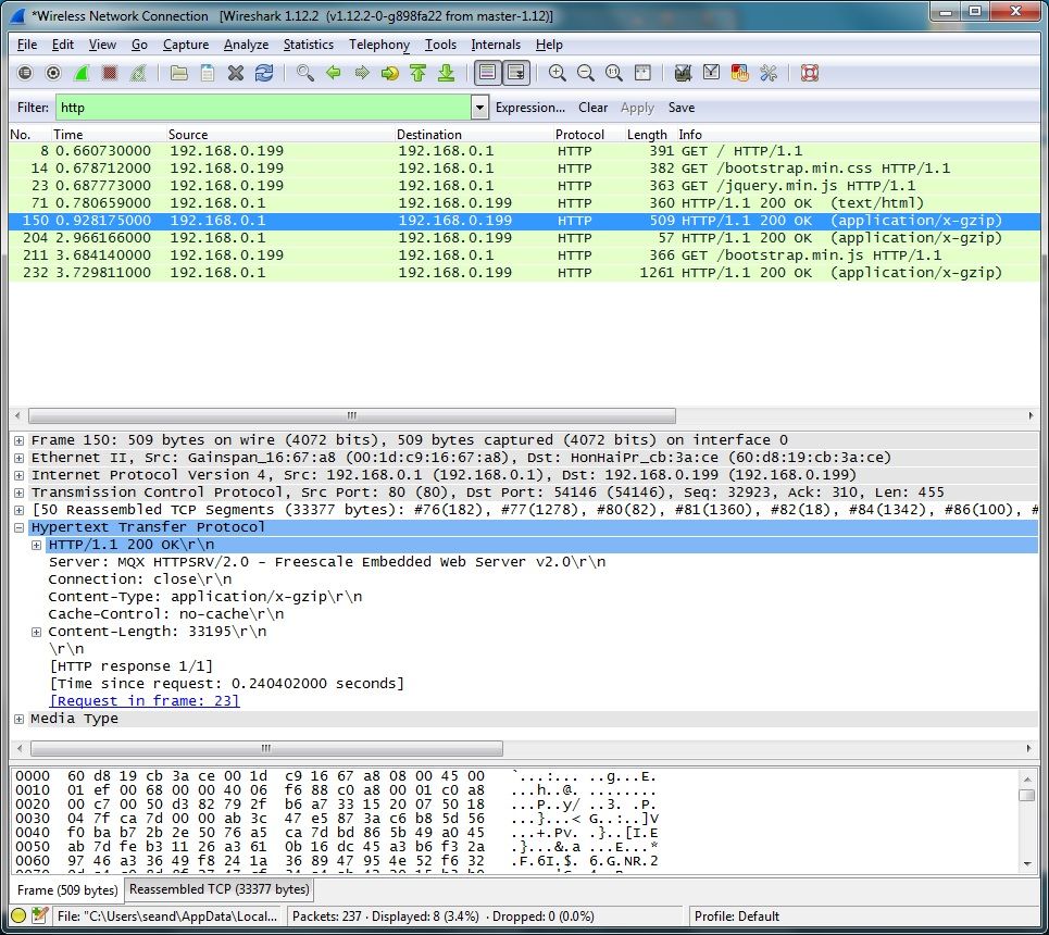

I'm running MQX 4.1.0.1 on a Kinetis K60 and attempting to use compressed files stored in TFS running on the built in RTCS web server. However I'm having some trouble getting it to work with compressed files. My page loads fine if I decompress the files leading me to believe the webpage code is ok. But if I have files compressed (in .gz or .zip) the web page does not display correctly.
I have 4 files, 1 .html, 2 .js and 1 .css file. I have gzip compressed the .css and .js files. So they now have a .js.gz or .css.gz style file name. I realize .gz is not supported by default but using the supported .zip does not work either. The page loads just as poorly with both.
Following the instructions listed here Re: Re: How to set Content Disposition? I have added support for .gz files. I'm guess I did this ok since it at least works the same as the included .zip support.

Unfortunately compressed files are not supported in current MQX web server, but your modification looks OK and it should work however we didn’t test such modification till now.
Ideas:
I guess that HTTP header should contain in this case
Content-Encoding: gzip
for let client to know which decoding mechanisms has to be selected in order to obtain the media-type referenced by the Content-Type header field.
For details:
http://tools.ietf.org/html/rfc2616#section-14.11
Please try additionally modify code for generating header file and add there Content-Encoding entity-header field.
Your picture shows Wireshark capture with filter (not all data, it seems that bootstrap.min.css.gz has 30kB). Are you sure that files were fully transferred?
Note: You selected FALSE as option for Cache. I suppose that css and js files will not be changed dynamically. So, I guess that cache at client side has some sense for these files. Anyway, this should not have any influence on main result – if it will work or not.
I hope it helps you.

Found out a little more info. Digging around in the web server code it appeared that it was searching for files with a .js or .css extension and not the .gz that is should be. All of my .js and .css files are gzipped. Just to see what would happen I modified httpsrv_process_req_method() in httpsrv_supp.c to append .gz to the 3 files that need it.
if(strcmp(uri_begin, "/bootstrap.min.css") == 0 ||
   strcmp(uri_begin, "/bootstrap.min.js") == 0 ||
   strcmp(uri_begin, "/jquery.min.js") == 0)
    written = snprintf(session->request.path, server->params.max_uri, "%s.gz", uri_begin);
else
    written = snprintf(session->request.path, server->params.max_uri, "%s", uri_begin);
I then did a Wireshark capture and I'm now seeing the expected Content-type of "application/x-gzip" but my web page still displays incorrectly.
I'm still not sure what is wrong but thought this might be useful info to someone who knows more than I do about the web server.
Sean

"Content-Encoding: gzip" was the fix. I also had to have "Content-Type: application/javascript" or what ever is appropriate or IE would not load the page. Though Chrome and Firfox were fine without Content-Type.
I ended up modifying the webserver to always put in "Content-Encoding: gzip" for .js and .css files since all of mine are gzipped.
Thanks for the help!

    {sizeof("js_gz")-1 ,"js_gz", HTTPSRV_CONTENT_TYPE_JS_GZ,      TRUE},          //New js_gz file extension
    {sizeof("css_gz")-1,"css_gz",HTTPSRV_CONTENT_TYPE_CSS_GZ,      TRUE},    //New css_gz file extension
    /* Following row MUST have length set to zero so we have proper array termination */
    {0,                      "", HTTPSRV_CONTENT_TYPE_OCTETSTREAM, FALSE}
if (has_entity)
     httpsrv_print(session, "Content-Type: %s\r\n", httpsrv_get_table_str((HTTPSRV_TABLE_ROW*)content_type, session->response.content_type));
     //If we are serving a GZIP file then add the required header so the browser knows to decompress it
      if(session->response.content_type == HTTPSRV_CONTENT_TYPE_JS_GZ ||
        session->response.content_type == HTTPSRV_CONTENT_TYPE_CSS_GZ)
           httpsrv_print(session, "Content-Encoding: gzip\r\n");
I have one large JavaScript library that gzips from 400k down to 80k so serving the gzip version is much faster. My slowest page, that has two large .js files and two large .css files, was taking about 15 seconds to serve and now only takes about 3 seconds with the gzip in place so definitely worth the effort.
