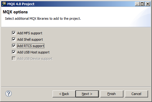

Hi All,
I am using twr-k70F120M "kit".
I have twr-ser1 board. And elevator boards with me.
i am using freescale codewarrior 10.5 special edition(free version) + MQX4.0.2
I want to use thumb drive(usb mass storage device) for following
    1)      Data logging.
   2)      Updating code into processor.
how can i obtain above?
Please provide documentation if you have for this + some example code.
I have got HVAC example and I feel it is writing data in USB mass storage device.
But when I enable its                   "#define DEMOCFG_ENABLE_USB_FILESYSTEM  0  /* enable USB mass storage */"               flag, it says code size increased  (because I am using freescale codewarrior 10.5 (free special edition) + MQX )
Is there is any small project example using which I can log data in USB mass storage device??
Kindly reply ASAP.

Hi Sudhanshu,
Let's go back to the basics. Try to create a new project for MQX for the board you are using but this time make sure you are addind the USB libraries like this screenshot:
Then, in this new project just add the USB code form the web_hvac. Just try to make the logging. Let me know if that works.
Garabo

Luis_Garabo
Hi Sudhanshu,
Garabo

sudhanshumehta
THIs is great... I thank you Grabo... BOOM i am happy.. thank you for the support.
It was critical for my project...
