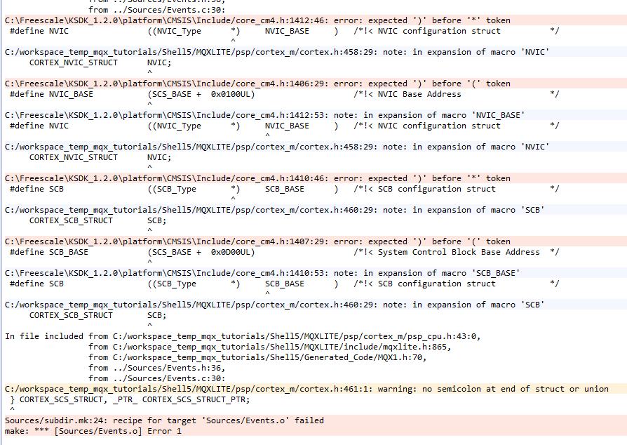

core_cm4.h compile errors? How can stock files have this problem? Did i miss an include?

Hey guys,
I currently am trying to build my project on kds 3.2 with sdk 1.2. Processor is MK60d100.
I have created a basic mqx application and am trying to add the shell to it.
Following the guide:
How to add MFS and Shell support to a new MQX RTOS for KSDK and PEx project
I am getting the following errors....
What am i missing??
Thanks for your time,
Jason

jasonscott
I think it has conflicting problems with the generated files from the processor expert and the library files used in the sdk.

danielchen
Hi Jason:
Thanks for sharing, maybe make clean can resolve this issue.
