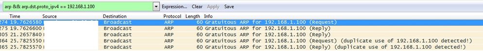

Luis_Garabo
Hi Vines,
I did a test and it is working on my side. I am able to see in a few seconds that the router is rejecting the request of the same IP address. I did this test with no time delay added. Take a look to my wireshark screenshot:
The only change I did was to give static MAC address to each code I flashed in the two different tower systems. That is something I missed in my previous replay. You need to make sure the MAC address are different for each tower. Other way the router will believe it is the same FEC asking again for the same IP so, that of course has sense.

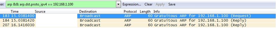

Scenario 1 (connected to network and gateway)
1. Device 1 connected to router A
2. Device 2 connected to router B
3. both router A and B connected in the local network
4. for ipcfg_bind_staticip to work, there needs to be a delay
Scenario 2
2. Device 2 connected to router A
3. Router A connected in the local network
3. ipcfg_bind_staticip works perfectly (no delay needed)
Scenario 3
(not connected with network and gateway)
1. Device 1 connected to router/switch
2. Device 2 connected to router/switch
3. router/switch not connected to our network. Purely for connection between device 1 and device 2
Scenario 2 and 3 screenshot:
Scenario 1 screenshot:
As you can see there is no request captured in wireshark even though I am using exact codes from scenario 2 and 3.
So I guess that explain why ipcfg_bind_staticip wasn't able to capture an error in Scenario 1. The big question is why is it behaving differently on this setup. I read somewhere that some experienced this problem before with different routers. I just don't know how true. I am using MQX4.0
