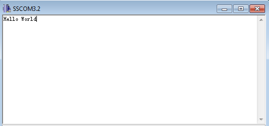

danielchen
I tried the interrupt version :    ittyB.  Please refer to my attached files.
I run the hello world example, it seem ok on my side.
