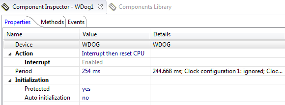

I have K60 towerboard:_K60P144M150SF3RM , MQX 4.2 Code Warrior v10.6.4
Using PE generated Watchdog with Interrupt then Reset CPU option:
The interrupt is INT_Watchdog,
but I cannot find anything in the Init() generated code that the INT_Watchdog is associated with any ISR.

Where is the interrupt routine for INT_Watchdog? Do I have to install myself?
In the example, watchdog.c under mqx example folder, it shows a watchdog test using system timer as watchdog. It can call interrupt when specified time duration expires. It can be added with a CPU reset in the ISR(). To me, this is the same as watchdog timer defined with interrupt and then reset CPU. What are essential difference between Watchdog timer and a system timer is used as watchdog function?

Hi David:
The difference you mentioned is just like the difference between hardware watchdog and software watchdog.
Hardware watchdog:  If the application does not reset the timer within a certain time, the hardware generates a reset operation. As such, a hardware watchdog timer monitors the entire application on a processor, it does not monitor individual tasks.
Software watchdog: The MQX RTOS watchdog component provides a software watchdog for each task. If a single task starves or runs beyond certain timing constraints, the watchdog provides a way to detect the problem. Initially, the task stars its watchdog with a specific time value, and if the task fails to stop or restart the watchdog before that time expires, MQX RTOS calls a processor-unique, application-supplied expiry function that can initiate error recovery.
Regarding the hardware watchdog, please refer to the attached Kinetis watchdog module validation code. I did not try the watchdog PE code before.
Regarding the software watchdog, please refer to the watchdog demo under MQX installation folder.
C:\Freescale\Freescale_MQX_4_2\mqx\examples\watchdog
