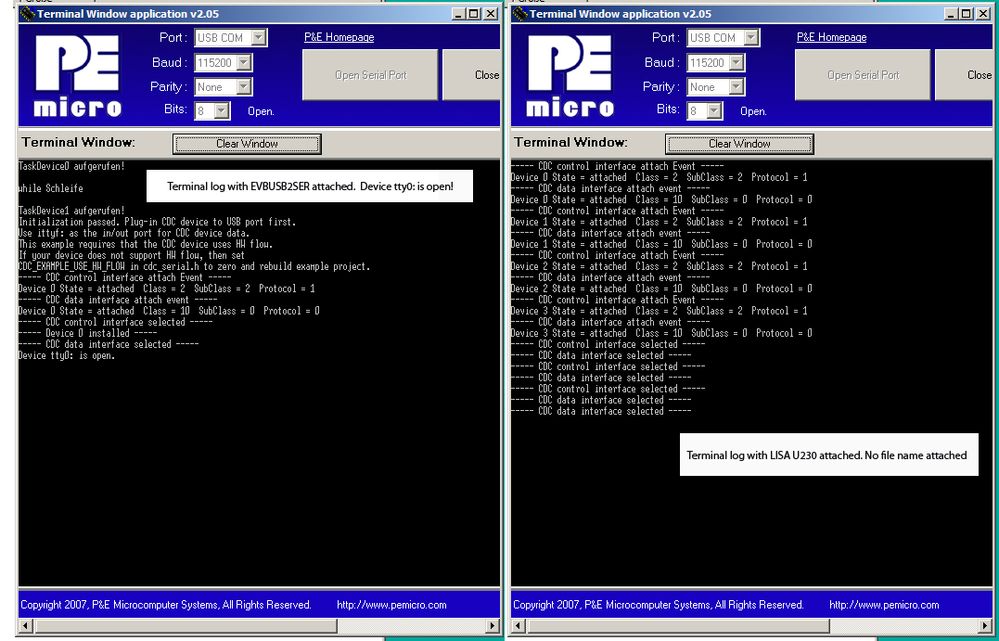

ThomNet
Hi Martin,
I have testet your cdc_serial.c file and I have checked it with the EVBUSB2SER board and with the LISA U230 board. See the two terminal logs.
I'm wondering that with the USB2SER it opens tty0 (good guy!!) but with LISA it opens nothing. With LISA shouldn't it open at least tty0 and tty1? Do you have any idea why?

Martin_
Hi Thomas,
I guess it is caused by the order of the events. The code I sent expects an attach event is immediately followed by an interface event, as this happens when you attach one by one device via USB hub. Your device seems to have different order of events - it goes through attach of all cdc devices, then it goes via interface events of all devices.
To modify the applicaton behavior, we can add a short code into interface event switch cases, to find index corresponding with the device that caused the interface event. Proposed cdc_serial.c is attached. Please let me know if it works.
-Martin

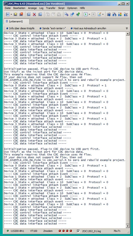

ThomNet
Hi Martin,
thanks again!!
I have checked the file, you've send to me. It's the same behavior as before. I have attached the terminal log screen shot with 3 x the attach log.Terminal log with new cd_serial_2013_0218.jpg
Interesting to watch is the fact, that one control interface seems to be missing?
May be this gives a new idea?!
All my best again
Thomas
17,711 Views
Martin_
Hi Thomas, actually, I inadvertently introduced an error in application data interface callbacks.
Hopefully this one is correct. The handling of multiple cdc data devices is at application level, it should be easy to debug.
