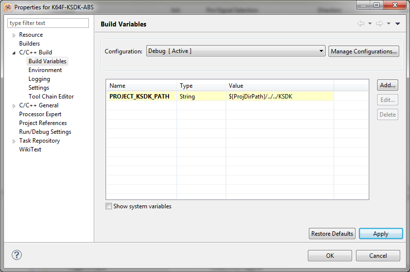

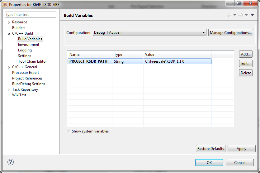

2.- There is no need to manually modify the absolute path on the .project file, you can do this on the project properties by going to C/C++ Build > Build Variables and editing the PROJECT_KSDK_PATH build variable:

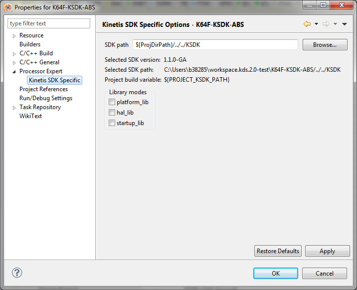

After changing the PROJECT_KSDK_PATH build variable and applying the changes you will see that the SDK path is also updated on the Processor Expert settings:
3 and 4.- I have run some test and did not get any errors after changing the SDK path following the steps above, can you try it and let me know if you still get the errors while generating the PEx code?
