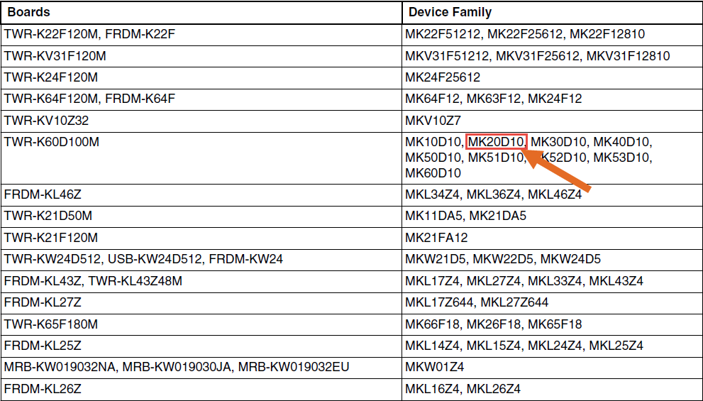

soledad
Hello Jan,
MQX Software Solutions are available in three variants to meet your embedded design needs: MQX RTOS for Kinetis SDK (MQX for KSDK), traditional MQX RTOS and MQX Lite. However unfortunately there is no support for KL03 devices.
1. MQX RTOS for Kinetis SDK
Freescale MQX RTOS for Kinetis SDK is the latest evolution of the proven and professionally developed Freescale MQX™ Software Solutions for Kinetis MCUs. It is built on top of the software development kit (SDK) for Kinetis MCUs, leveraging the flexible and extendable peripheral drivers found within the SDK. MQX Lite configuration option is now available for enhanced scalability, allowing developers the option to use the same light weight kernel API found within MQX Lite RTOS.
MQX RTOS for Kinetis SDK supports the below device families.
2. MQX RTOS
Freescale MQX™ RTOS a full-featured complimentary real-time operating system including the MQX™ Kernel, TCP/IP stack (RTCS), embedded MS-DOS file system (MFS), USB host/device stack, and more. The MQX™ multitasking kernel provides pre-emptive scheduling, fast interrupt response, extensive inter-process communication and synchronization facilities. MQX RTOS includes its own peripheral drivers. MQX RTOS doesn't support KL devices however this version supports K20 devices.

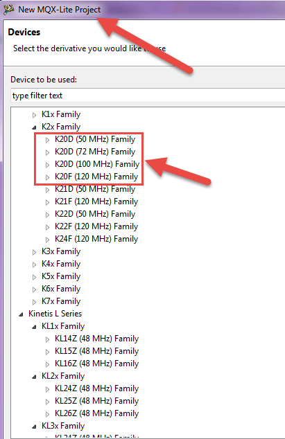

3. MQX Lite RTOS
Freescale MQX™ Lite RTOS is a very light MQX™ kernel for resource-limited MCUs. Initially developed for the Kinetis L series family, it allows applications to run with less than 4 KB RAM. It is a true subset of the proven and professionally developed Freescale MQX™ Software Solutions, allowing for easy upward code migration. It is easily configurable within Processor Expert Software to be used with the tool chain of your choice.
This version supports K20 devices but it doesn't support KL03 devices
