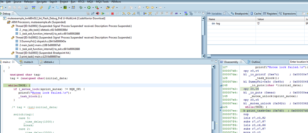

I've modified the mutex example for MQX 3.8.1 to have 4 instances of the Print_task(). I'm trying to add a time delay to the task depending on
the "tag" I specified to be the first character of the string and depending on that value it would create a time delay for that instance before sending out.
Is this a code problem or is it a conceptual problem because I'm unable to see the variable data while stepping through the code for both "initial_data" and "tag" variables. I've attached some screenshots to show what I mean.
The reason I'm doing this is because I plan on creating a  code with GPIOS that send the data from each GPIO with a time delay depending on which GPIO it is coming from. Any advice on this subject would be greatly helpful in my project.

Can you see the variable in the "Variables" tab/window which is two tabs to the left of your "Expressions" tab?
Once the "Variables" window is displayed, if you want to see a global variable, right click in the window and select "Add Global Variables" and pick which one to view.
David

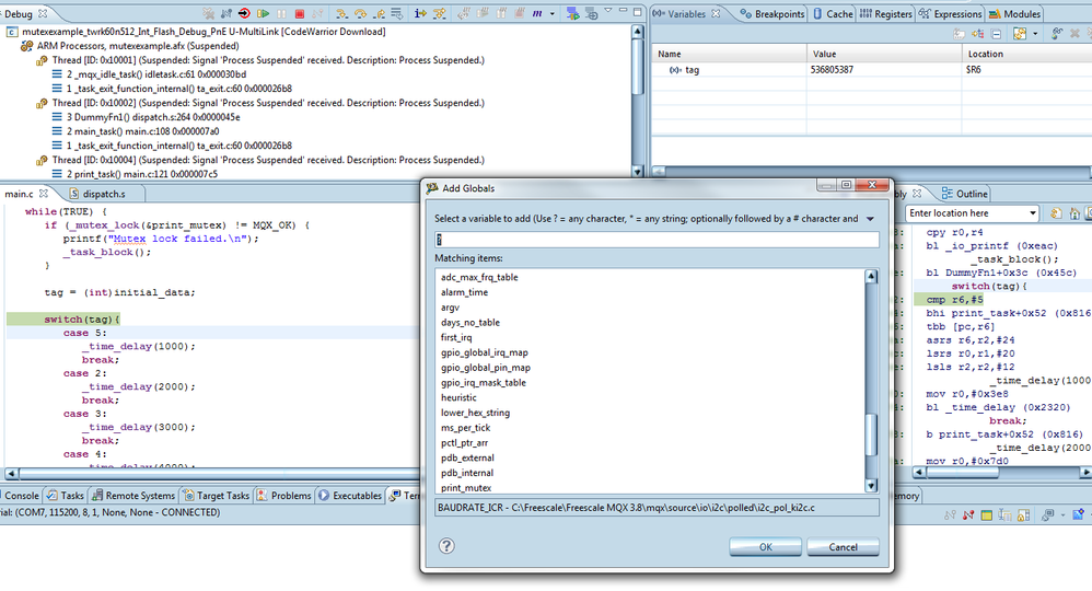

Hi David,
I forgot to include that I have tried this method but I'm still unable to locate the initial_data variable in either window. I've attached a screenshot of your method.
On a similar note, I also tried to view string variables where the initial_data came from but I wasn't able to see any of the strings in the variables or expressions window. Where is this data being stored since I'm unable to find the memory location for these using the aforementioned windows.

first of all, why is your concern the parameter? You copy it into tag variable which is in variables window and you can see it's value which is an address of an "array of char".
Your program creates one instance task print and it's input parameter is implicitly cast to uint32. It's pointer's address which points to an array of char which is casted. Therefore your label sentence switch does not work as you expected. If you want to pass a string and use it as an expression in switch, you can use atoi for example (for you string it would return 0). You would find out if you provided default label.

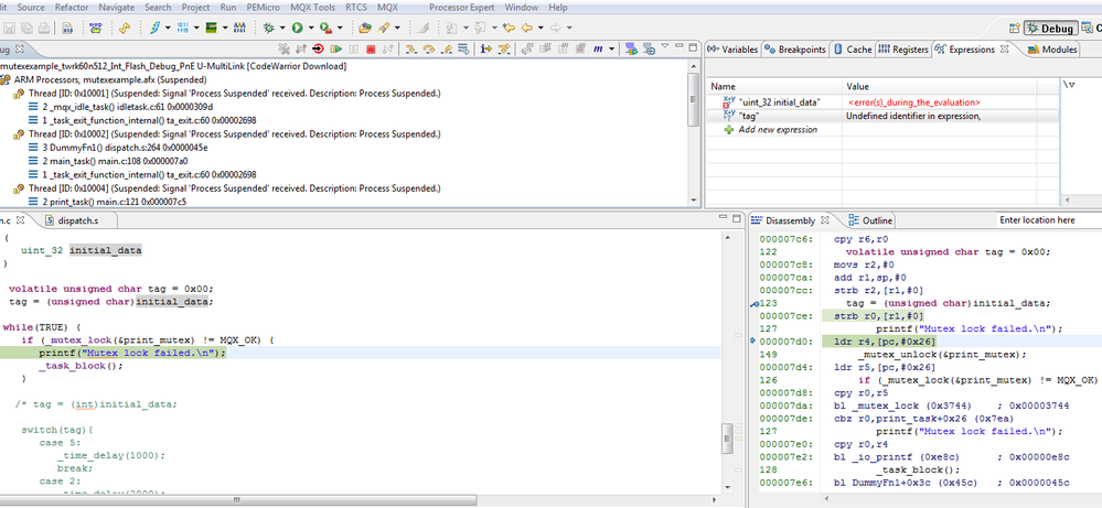

I've tried that method and I'm still getting the "undefined identifier in expression" error. I've attached a couple screenshots. Could this watch expression problem be due to MQX and how it runs? The reason I ask is because I've tried adding code (just variable declarations and some if statements) but I'm unable to see any variable data in those windows.

You do not use that variable and compiler might optimize it away. What is the target (debug/release) . Are optimizations on?
Anyway, this is CodeWarrior related question with expression tab error . Strange,in variables tab, the value of it is shown.

I'm not an expression expert but since the tag variable is in a register, maybe that is why the expression is not working?
Have you tried making tag a "volatile".
David
