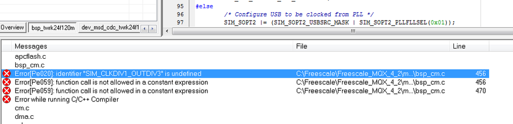

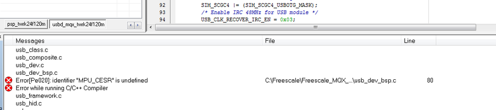

danielchen
I replaced with your modified files in my demo, unfortunately I can't compile successfully, maybe some modified files are missing
Please see the below pictures.

leifzars
Sorry this file contains the missing defines. https://dl.dropboxusercontent.com/u/12902970/MK24F12.zip
5,957 Views
danielchen
Now I downloaded your head file, can compile it successfully.  I will update you when I have results
