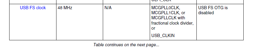

danielchen
Hi Arnaud Girard:
Glad to hear it can work when you change frequency to 48M.
USB clock should be configured to 48Mhz.
Please refer to the reference manual for K70P256M150sf3. Page 216
Have a great day!

arnogir
Senior Contributor II
Ok, I haven't check that, I just check the USB v2 which indicate we can work up tp 60MHz:smileyblush:
I had try to change the Clock configuration to make a check during my research,
But with any other value than 1/3, USB never working:smileyconfused:
On 150MHz CPU clock, the value was like bellow. May be there are forbidden couple of value?
Which value can I set with 150MHz CPU clock to have a working USB?
