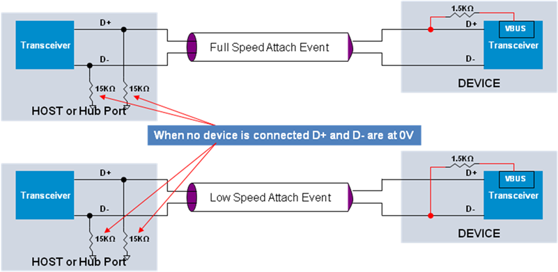

I'm using various micro-series Kinetis K70, K22 and MQX 4.0.2.
I'm using the USB, but I can not work with USB 2.0.
Communication is very slow.
Is there any change to the driver that allows you to work with the 2.0?

Hi Maurizio,
The only option to change the speed in a  usb device it is not by software it is by hardware, you need to add a pull-up resistor from D+ or D- depending of the speed, you want to select.  For a full speed device, the pull-up is attached to the D+ signal.  When the host detects this voltage change then it begins the enumeration process at the full speed rate.  If the voltage change is detected on the D- line, then the enumeration happens at low speed.

Microfelix
dear SOL
I tried to put down pullup on D + and D-host.
With a pen-drive usb 2.0, I always loading very slow.
Should I do anything else?
