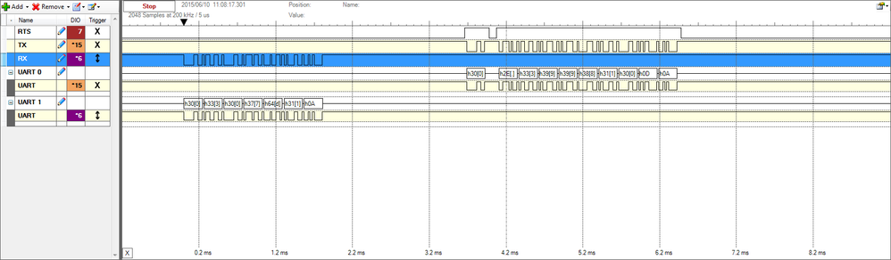

I am trying to run a UART with a RS485 transmitterdevice which I am controlling with the RTS (request to send).
My Problem now is that, as soon as I use higher baudrates (i.e. more than 9600) on the UART the timing of the RTS seems to be messed up (see image) or the
UART itself has interruptions while sending bytes.
The RTS goes down between some bytes which, in my case, deasserts the RTS and disables the transmission of the attached transmitter.
I don't think that this is actually wrong from the view of the RTS but either my RS485 Adapter or the Serial Console interprets the transmission interruption as a Stop.
So the question would be: How can i get my UART to run with high baudrates so that it doesn't have those interruptions in the transmission?

The RS485 example was my base to start. So the only difference to what I do is, that i am not writing things with the write(.) function
but I am using the printf function.
This should be a proper use from my understanding?
Anyway, I tried to run the example and compare results and the problem seems to have vanished.
I then tried it with my project and I found out that i have a TimerInterrupt enabled in my bsp(with Processor Expert) on a 1ms
basis.
As soon as I am running my own methods in the connected TimerInterrupt event, the UART interruptions
occur again.
So at that point I am not sure why this is happening
